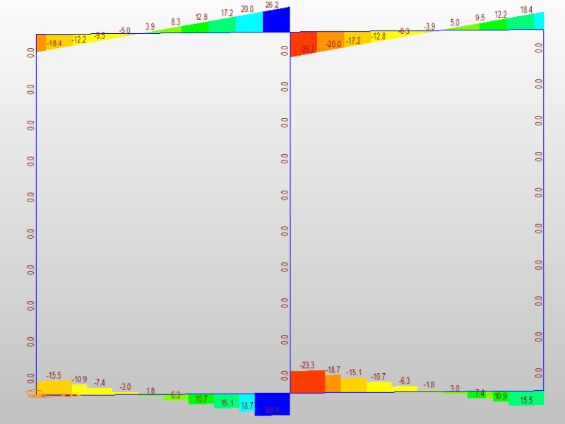

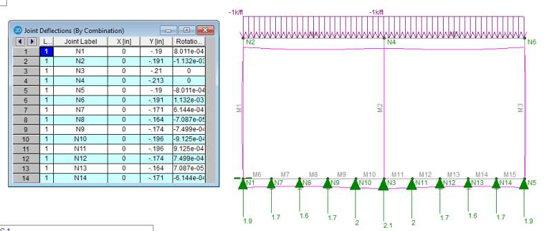

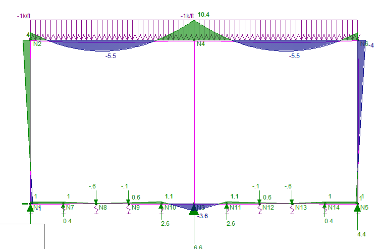

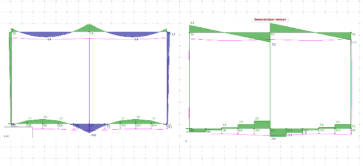

Below is a 2 cells (2-10x10) box culvert model I ran. Each support node has a spring with k = 10k/in. For simplicity, only the roof is loaded with 1 klf uniform load. FRom this model, I got everything need for design.

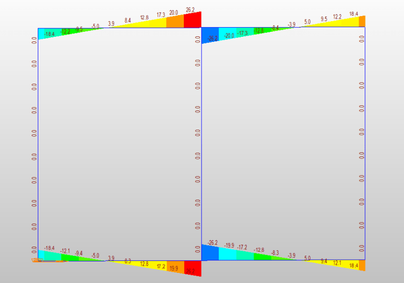

Below is the comparison between area springs (first picture) and the equivalent point springs (second picture). For moment in the bottom slab, there is virtually no difference in results between the two methods, but for shear you can see that the point springs will underestimate the shear in the bottom slab. I suppose this difference could be minimized by just adding more nodes and more point springs.
The small difference is no big deal. I've never thought of it, what is the advantage of your method? Just curios.
Exactly, divide the last slab elements adjacent to the wall elements up and you should see the results converge.
In addition, based on your later post, you should create a node that corresponds with the edge of the haunch which is where you should be analyzing your shear

Results below is to demonstrate effects of the change of spring constant from 10 k/in to 1000 k/in. This has been the reason I prefer the elastic spring model, if the spring constant is available, and realistically represents the characteristic of onsite soil.

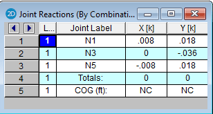

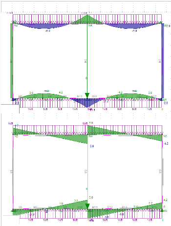

This is a model with pinned supports and uniform load at the base.
Here is support reactions.
