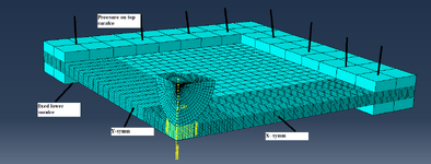

Hello all,
I am modelling a 10 layer composite laminate with Frame (shown in figure). I am little bit confused regarding the boundary conditions to be applied for frame. I am applying two frames bottom frame and top frame. For bottom frame the bottom surface is fixed and on top frame i am applying a pressure of 350 kPa. The value of pressure i have considered from a scientific journal paper in the filed of low velocity impact. I have applied a symmetry boundary conditions on two faces i.e. on x-symm and y-symm. with 10 J (mass of the impactor =5.65 kg and velocity is 1.735) my plate is sliping from the frame support. So please help me what boundary conditions should i apply for frame . I have to apply frame.

What are the contact properties between the frame and the plate (mainly friction coefficient) ?
Sir, i have one more doubt. I am applying an element deletion criteria. Is this the right way to do ?
