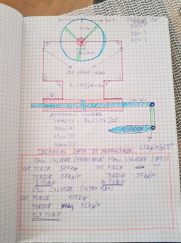

Hi to everyone, first I wil try to put here my current system, then what I would try to do and then couple of questions. This may be a big thread but my apopogies.
The current problem on my sailboat is that somebody before I bought it had putted hyrdaulic steering on 31 foot boat, and made couple of mistakes along the way.
So courrent setup is that i have:
28cc/turn steering helm pum connected to 70cm diameter steering wheel - axial piston pump
168cc capacity steering hydraulic cylnder
System max press 70bar
This gives me 6 turns from end to end, and main problem is that I dont feel the rudder at all(no feedback). I have been googling it a lot and found that there is couple of solutions.

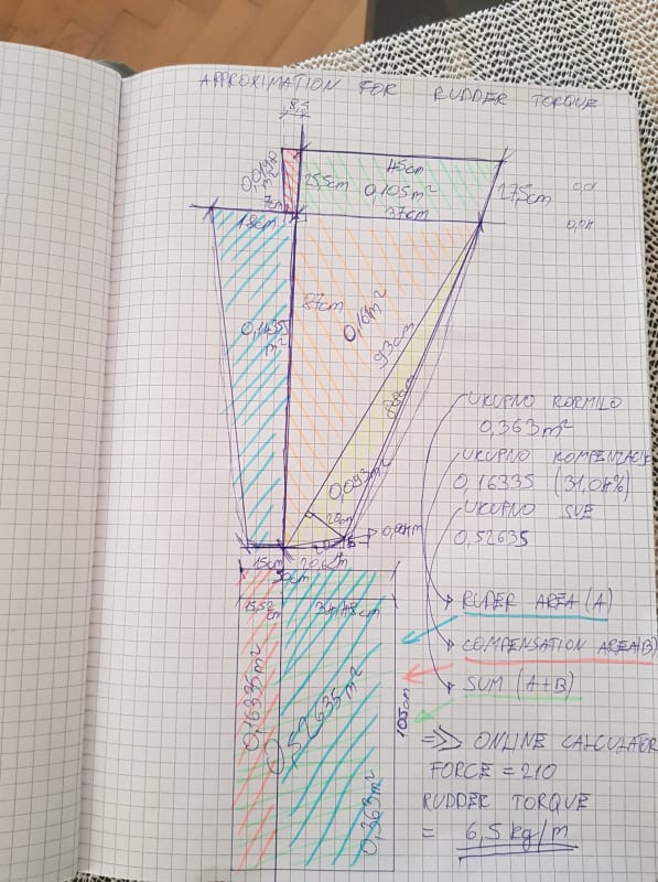

Recently I calculated my rudder torque by calculateing area an running it in calculator and got 6kg/m. Pictures attached, Calculator web site is on this link..
Calculator gave me:
Force of 210
Rudder torque of 6kg/m
I am not sure since there isnt any units; what this should mean
Solution 1.
I would like to go for 69cm3 (2.5 turns) capacity of hydraulic cylnder but I dont know if my autopilot will be able to handle it becouse friction of fluids and pump. As well max torque of cylnder is 32 kg/m but output force is 170kg.
Solution 2.
Another option is to go for 84cm3 (3 turns) capacity of hydraulic cylnder but I dont know if my autopilot will be able to handle it becouse friction of fluids and pump. As well max torque of cylnder is 58 kg/m but output force is 387 kg.
Lady in Hydrodrive told me:
On application 28cc pump and 84cm3 cylinder, on shaft pump, to reach the max pressure, needed a torque of 42 Nm on pump shaft.What does this mean if my max torque from rudder is 6kg/m?
But I want the feedback as well.
The main question is how to calculate how much stiff my steering wheel is going to be, since I want it to be just on border so my autopilot can handle it, to have feedback, as little as possible turns and normal effort steering.
Thank you for your Help and time

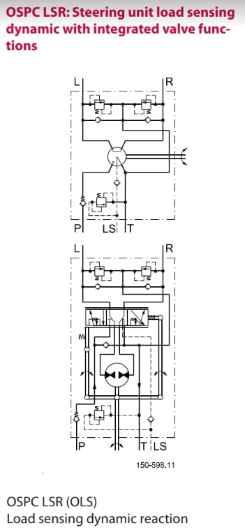

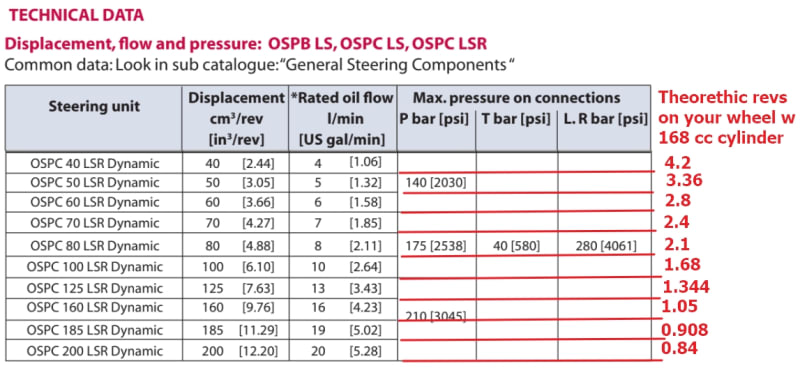

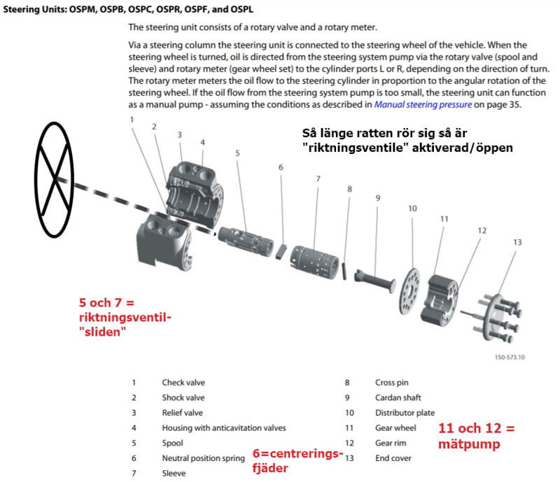

You need an Orbitrol steering unit like this one from Danfoss.

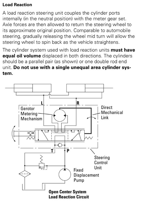

"Reaction" means that the steering wheel has "hydraulic contact" with the rudder. This valve below is made for a Load Sensing, LS, pump system so it will work with a pressure compensated variable displacement pump. or an LS fixed displacement pump.
Eaton has their own line that basically works the same way. This one is with "Open Center" and made for a constant flow system pump.
This steering system can also be manageable without a servo power pump. The steering unit has a metering pump built-in and the check valve between P and T on the images allows "emergency steering" which is tough on an articulated heavy front loader but should be an easy one for a rudder on a sailboat. The metering pump size is optional so you can get the right rudder speed contra how many wheel-turns you need for the rudder to go end to end

@akkamaan Thank you for time and effort, but system looks over complicated.Buying anything except cylnder is too expensive for me. For sure I am going to lok at it, google Danfoss pump as well. But I would rather modify my pump for force feedback( since I can remodify again, if I dont like it) and buy smaller cylnder for turns.
As well I saw that pump delivering press is more than max 70bar which can be resovled with relief valve, but it comes agaim to simplicity of system.

Found the cylinder and did the math...
Bore came out 30 mm with a 14 mm rod and 83 cc displacement volume. Max force as stated 3870N approx 387 kg (394.5 kg to be exact. (Force is measured in Newton, N, so it takes 9.81 N to lift a mass of 1 kilogram, kg. at sea level)
Calculated some other performance numbers too.
For your rudder torque calculations, you need to understand the unit for torque. It is not kg per m "kg/m" as you have on your pictures. Torque is "Force by distance", ie Newton by meter or Nm. if you are more comfortable to use the mass unit kg for the force so be it, but then it has to be "kilogram by meter" or "kgm"
Wow this is extraordinary.Thank you for time, you put into this.
Just to confirm. Is this power needed on pump shaft, not on 1m, on ideal system offcourse?
Than:
Torque (N.m) = 9.5488 x Power (kW) / Speed (RPM)
= 9.5488 x 0.196 / 60 for 1 (rev/sec)
= 23.26 Nm=2.326kgm( * pump effieciency) + friction in hoses due viscosity and bends >>for real systems?
Thus at wheel of 70 cm (diameter)
I will need to use 6.64 kg of push force at wheel.
How much I will need to use if my rudder needs 6kgm of torque and 210 of Force?
As gotten on below picture.
