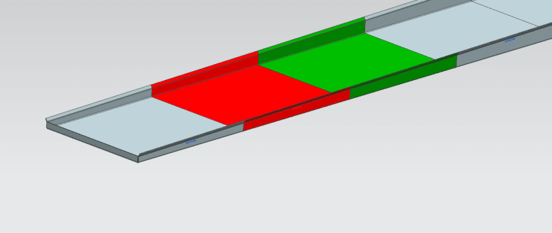

Im working on a set of sheet metal parts which all have similar shape. These sheet metal parts are all sections (sheet size) generated out of the same "dummy" model.
Since the models look the same i fugured I could make one draft from the green part and use is as a basis for the other part (red). Something like a quick sheet.
Lars
