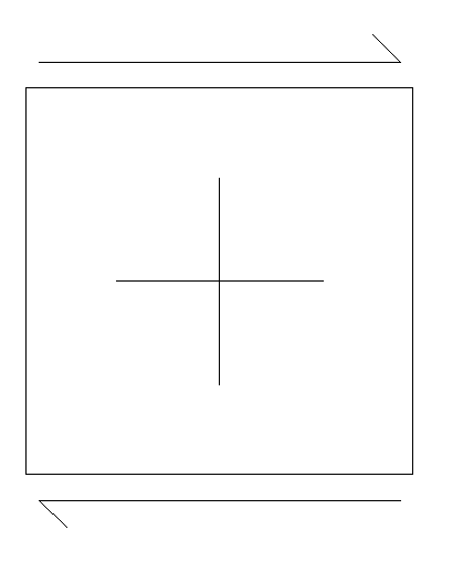

I think this is the crux of my question. Why is the axial load not a shearing load? If I have a discrete rectangular section as shown below, this appears to show a shear load in the element. How is this different than an offset axial diaphragm load at the top of the w-section, and a horizontal restraint (strap, weld, etc.) at the bottom bearing location?

When calculating total axial stress on a small element, axial stress, total stress at the top of the element = F/A +Sv and on the bottom of the element it is F/A -Sv
Sides of the element stress is +Sv on one side and -Sv on the other.
Right. In my field, Pipe stress does not have rectangular sections.
See "Mohr's circle"
Axial stress is not a shearing load because it is unidirectional stress, only in the axial direction, unless it is eccentric, then some shear from the additional eccentric moment is created.
Mohr's circle results in the angle and value of the maximum shear stress.
You can see from your sketch it does in fact cause some shear stress. The shear stress is calculate by VQ/It. If we ignore completely the w component from your sketch, you will find the shear diagram for the beam is uniform, and equal to your drag force V times the beam depth D over the beam length L. This assumes plane sections remain plane, which I guess may not always be true in these cases.
