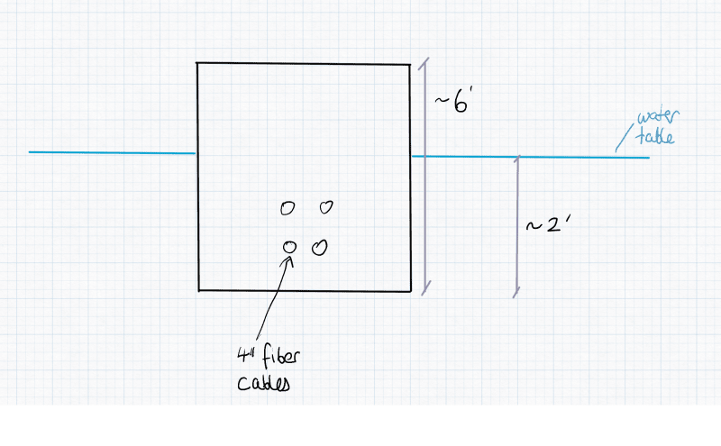

See below
The link seal gaskets look interesting.
So, are you saying that you tried to originally install drainage with your structure but that didn't work, so you made it water tight?
If my 4x4" pipes were cast into the concrete when the manhole walls are getting constructed would the surrounding concrete provide a water tight fit, or would I need a product like what you mentioned (linkseal)?

Yes, I estimate the water table is around 4' below grade. The location for this manhole is about 15' or so from the ocean. Do you have any recommendations for waterproofing mastic. Is this just to be applied on the walls? What is normally done for the underside of the footing?

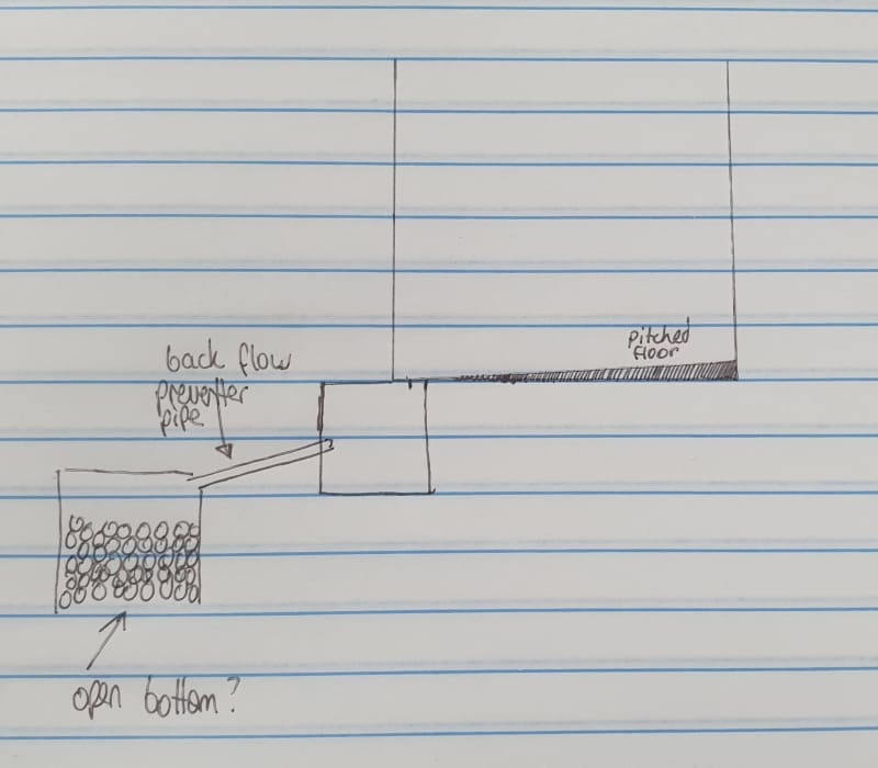

Hi Redacted
Sorry for the confusion, hopefully my explanation below clarifies.
The chamber was installed with a small 8" deep depression (sump) in one corner of the concrete base. The chamber floor sloped towards this depression to collect any water in the chamber.
In the depression in the base, a 4" pipe with a backflow preventer penetrated the wall (just above the bottom of the depression) with a linkseal gasket. This 4" pipe lead to an adjacent rock filled pit lower than the base of the chamber.
The intent was that any water that collected in the chamber would outflow to the adjacent rock filled pit outside the chamber.
Unfortunately the water table was higher that the rock filled pit, which made the gravity flow outflow useless (similar to the situation you have I believe)
The chamber was also intended to be water tight, but it was installed over winter so the peel and stick sealant around the chamber joints (precast chamber) did not work as intended (it was too cold and brittle to effectively compress and seal)
As well the backflow preventers in some of the chambers malfunctioned allowing water to enter that way (was told later that they were cheap ones).
Finally, the contractor tried to grout in the linkseal gaskets instead of tightening them to seal around the penetrations.
We explored the idea of putting a mechanical pump, but in our case it was not feasible due to power availability and the client felt maintenance would be an issue (township with limited resources).
In the end, the backflow preventers were repaired and all joints were sealed by drilling holes at the joints and injecting a expanding sealing foam (can't remember the product right now).
The water tightness was verified by completing infiltration/exfiltration testing. you may want to consider doing this, it is a good way to ensure the contractor delivers a water tight construction if that is what you have specified ( in our case there was an allowable infiltration rate based on the specification we referenced - something like 0.3% of the chamber volume in a 24hr period)

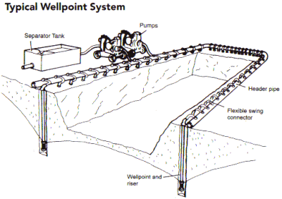

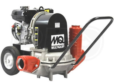

As a former bridge contractor, the first option I would consider for a "shallow" excavation, such as this one, is to start excavating. Use diaphragm pumps (mud hogs) to attempt to control water inflow. If this works, shape the excavation so that the pumps can use a "low spot", just outside the work area as a sump. For this manhole, 15' from the ocean, doubt this will be successful - inflow probably too great.
Second option would be well points, but if the excavation/pump attempt did not work, well points probably will not either - just can't handle large inflow.
Third option... retract my statement about a cofferdam not being necessary and design/construct a (ridiculous) 3+' deep (at low tide) cofferdam. The cost (relative to the cost of manhole) will be astronomical.
There are other ways to work below the water table, deep wells with submersible pumps, bentonite slurry cut-off wall & ground freezing, but those don't apply here.

@Canstruct12 Thanks that does make it a bit clearer. Did you do something like this (see sketch below)? If so, how would you maintain the rock-filled pit in case it got clogged up

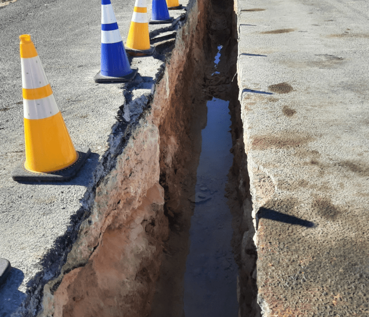

- Yes the water table elevation is pretty much a WAG. The client had done some trenching in the area a while ago and they have photos showing the water table in a 4' deep trench, see below.
