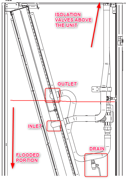

In one of the CHW projects, I had to deal with a cooling unit heat exchanger whose IN/OUT connections were located in the middle of its overall height. After the hydro test, the heat exchanger could not be drained properly, as shown in the picture, as the lower part of it would be flooded since the drain is not located at the lowest point.
Problem
Exchanger Type
Does anybody have any idea how this could be done?

Your diagram isn't correct and then the photo, presumably a typical, doesn't match either.
Can you correct the diagram so that we can actually see the flow path. Is there a vent anywhere?
It's a strange design if the designer didn't think about this or are you mounting it not as intended?
You're not giving us accurate information here I think.

Here is the real illustration
Unfortunately, I don't have the schematic for flow path inside heat exchanger, just for connection points.

How big is the assembly? Weight? Can it be positioned to drain better. I.e. laid at an angle so the tubes in the coil are horizontal with the drain valve below them? What is the MAWP of the coils?

Unfortunately no, the unit is fastened to subtrack or floor, and it is usually packed between the other equipment(standing cabinets)

It implies that this HX is being mounted 90 degrees out of the orientation it was intended for, i. with inlet and outlet on the bottom maybe?
All a bit odd. Are you sure there isn't a drain plug somewhere?
What does the piping look like on the other side?
Any vendor drawings?

The current orientation is right, since the HE is an integral part of the cooling unit, and the unit is basically a cabinet, there is no possibility of the wrong installation, it is just how it is.
There is no piping on the other side, and there is no drain for sure...also the lower part of the HE could not be reached, because the fan module is in front of it...it is possible to reach it only if a few things are disassembled, which is not really the direction I would like to go.
