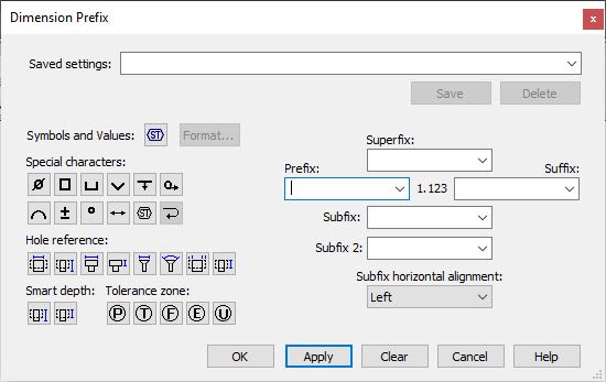

In it, I am instructed to create an annotation for a bunch of counterbored holes by selecting the appropriate symbols and typing in the dimensions. I am also instructed to type in a prefix to specify the total number of these holes.
Am I being instructed to do it this way, by typing in dimensions and quantities that have already been defined in the model, simply to demonstrate how it is possible to do so, or is this the 'correct' way to produce the annotation?

Hi John,
Look for the "dimension prefix" dialogue box. It has several buttons that can automatically pull the dimensional data from various type holes (counterink, counterbore, tapped etc.)
Also, for automatically getting hole counts, use %QC (counts holes on the same plane); %QA (counts all the holes of one type). These are available in the symbols and values button also on the dimension prefix dialogue box. Use the ones called "hole reference"
