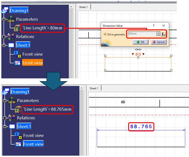

Hello everyone.
It is possible change value of dimension, in a drawing sketch, with a simple macro in CATIA?

Hi Wuzhee,
I want a change the numerical value, with a CATScript, for example from 132,505 to 150.
Thank you
DO you want to show a fake value (line = 132 but value = 150) or do you wan the geometry to adapt to new value?
in your case it seems the value will drive the geometry (not a fake value) Is that what you want ?
Not sure API could change value of driving dimension
Eric N.
Hello itsmyjob,
yes I want drive (adapt) the geometry with a new real value (not Fake)
Thank you
Are we ultimately talking about the modification of purely 2D geometry in a drawing, or, is the drawing geometry projected from a 3D model and the intent is to modify the 3D model from the drawing by manipulating the drawing dimension?
If it is truly just the modification of 2D geometry, another option could be to 'drive' the value via a Parameter in the CATIA drawing perhaps then get your macro to modify the Parameter value?
