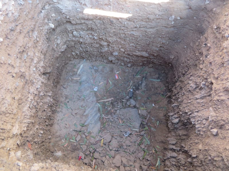

The contractors found a 12" culvert about 5' under where the drilled pier is to go. The vertical loading is only 500 lbs but with the weight on the concrete itself, the load will be around 4 kips vertical. The drilled pier is 2ft in diameter and embeded 5'. Moving the drilled pier is not an option. I can however, reduce the embedment by making the pier wider but I still have the issues with the surcharge. Is surcharge even an issue with these type of loading on an existing culvert that should have been designed for all of the soil weight above it and traffic loads?

The drilled pier is supporting a pole structure that can not move. The 12" culvert is 5' below grade and appears to be made up of corrugated steel. I have no idea if it is active or not. Please see below for a picture.
I'd try to find out more about it. If it's still active, then you probably want a geotech to weigh in and give you some recommendations. Though I think just digging deeper on the right side and letting the concrete pour down to a level closer to the bottom of the pipe would probably do the trick - as long as you're not expecting much lateral movement out of it.
If it's not active, then either do that regardless of lateral movement, or follow SRE's advice and grout it.
A section of it can be encased in concrete, or two footings can be installed with a bridge beam/pier above. Sleeves, insulation, or even CMU can be used around the culvert. Anything works really, but it requires a bigger hole.
It would not be appropriate for the new structure to rely on the existing culvert for strength, such as in soil bearing where it is surcharged. The culvert has a life expectancy, and it gets replaced at the end of it.

Hello LittleInch, what is the difference between vertical bearing pressure for liquid concrete vs solid concrete. I understand liquid concrete would affect the lateral pressure but vertical pressure should be the same if my understanding is correct. As for my approach, I plan on adding 9" of compacted soil above the corrugated pipe and just pour concrete over it. I effectively reduced embedment but increased the width of my foundation. Considering that the additional load is only 500 lbs vertical, surcharge should not be an issue on this structure especially if my foundation is now going to be 2.5'x2.5'. In addition, this corrugated pipe should be rated for traffic load since it goes under a road and a parking lot. The equipment and the bollards around it, if anything should shield the corrugated pipe from any traffic load that could surcharge it more.
TWC3 - when the concrete is wet, it is a fluid load and has no internal stiffness. Once it sets up, the load follows the most rigid path. So if you fill the hole up with wet concrete, the pipe can collapse and the concrete will just follow it and crush it all the way. Solid concrete, on the other hand, will start to crush it but 1) the encasing concrete will limit distortion and stiffen the pipe (concrete has to crush for the pipe to flatten) and 2) as the pipe "starts" to crush its stiffness will drop and the relative stiffness of the soil supporting the solid concrete next to it will increase as a result. Load goes to the relatively stiffer support. End result - pipe isn't significantly deformed.
