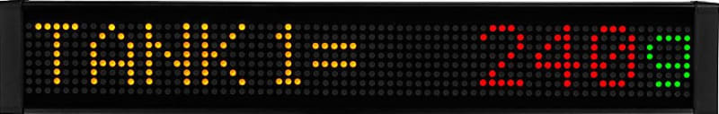

Another option is very large and bright displays.
You can buy LED panels that are very bright (>8,000 NIT) and display anything that you want on them in any size that you want.
You may need to go the Arduino/R-Pi route to handle feeding it and scaling.
ViewMarq MD4 series industrial LED message display, 1 line x 12 characters, 1.5in and 2in, supports (2) serial ports and (1) Ethernet port for configuration and external message control, NEMA 4/12, indoor use only.
Perhaps one of these industrial message displays.
If it can't take a serial stream out of the DRO and interpret it you could use a bare-bones CLICK! PLC cpu module to interpret between the two. For cost reduction you could use the single line message display above and have a single button that cycles thru the DRO axis to show just the one of interest.
Or spend more and get up to a 4 line display.
ViewMarq LED Message Displays

Thanks for all the suggestions, certainly given me some new avenues to explore.
The industrial message board sounds a good idea, but getting the Easson DRO to talk to it is well beyond my electronic know how.

If some electronics expert wanted a side hustle they'd do worse than figuring out the interface between a common DRO, ( Easson?), and a big message board type readout.
I'm sure such a thing wouldn't be useful to only vision impaired machinists, ( ! ), but as displays in factories that have lots of automated machinery, and not many humans.
