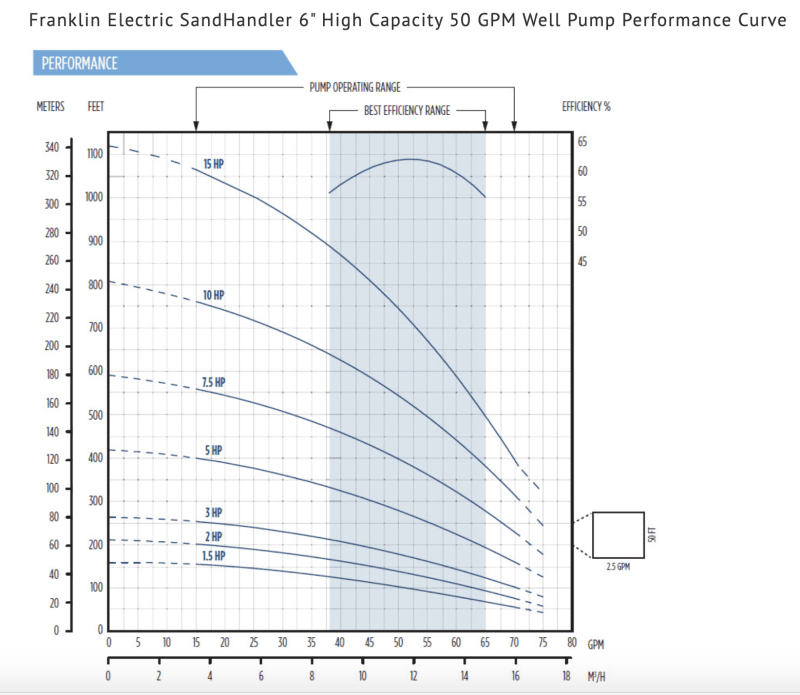

I have this old pump collecting dust, and if i can get my generator running this system has legs. With the above info, in mind, I feel it would be beneficial to add a storage bladder to reduce my gpm demand. With this system would i be able to push the original 2 miles in 1.5 or would the pressure be too high for HDPE. Or would it be more realistic to just push the 1 mile?
Which pump power?
How big is the storage bladder?
The pump looks about right for your original 1 mile 50gpm requirement to 300ft. The 10Hp rated pump gives a 550ft head at 50gpm and you only need 500 ft to reach the 300ft elevation. You will get slightly more flow.

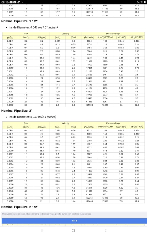

A 2 mile long 2" diameter at 48gpm needs 171 psig for flow loss which is 400ft head.
Add elevation of 200 ft brings that to 600 ft total feet head, or 700ft total head to pump up to a 300ft elevation.
Considering the pump only
If its the 10Hp pump, you can pump 42.5 gpm at 600ft head, so you can lift at least 42.5 gpm to 200ft elevation. Pumping up 300ft elevation (700ft total head) will get you at least 30gpm flow.
Looking at the 2" pipeline table, 32gpm only has 1/2 the flow loss of a 48gpm flow, so a 2"pipeline would only lose 200ft at a 32gpm rate. Flow would go up to around 36gpm to a 300ft elevation. Or you would be at around 44 gpm going to a 200ft elevation. (A bit of guess work there, as I have not run the numbers out).

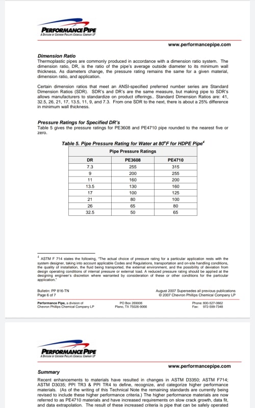

I think, if I remember right, it's still in the HIGH range of HDPE, but 2 miles with a 300ft lift is getting on to 300psig, so it will be very close to HDPE limits.
Your pump will probably work out to some acceptable compromise, its the pipe pressure that could be the problem. See what the max pipe pressure allowable is that you can buy.

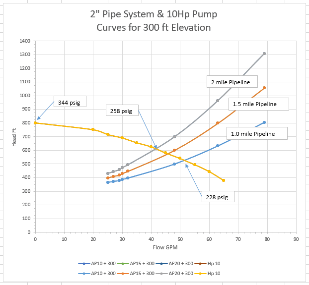

I plotted the total pressure drop "System Curves" for 1, 1.5 and 2 mile long pipelines, each with a 300 ft pumping lift.
I plotted the 10 Hp pump curve on top of those system curves.
The pipe/pump system will operate at the intersection of the pump curve (yellow) with the respective pipeline's length curve. Pump discharge pressure for the 2mile pipeline will be 258 psig at a flow rate of 42 gpm. The 1 mile long pipeline pump discharge pressure is 228 psig at a 52 gpm flow rate.
Disregard the legend's top line.
If you can't find pipe with a 344 psig allowable pressure, you should add a relief valve at the pump discharge and set it to the allowable pressure of the pipe that you do install.

I was looking more closely at the GE Cross section you posted and that shows an elevation change of 370ft, not the 300ft. If you do want to pump to 370 ft, the curves will change, but its easy to make new curves. Just raise them by the difference in the new elevation and 300ft. If you do need to pump to 370ft, then slide all 3 pipeline curves upward by 370-300 = 70ft higher. Leave the pump curve where it is. Notice that the 2 mile long pipeline would then intersect the pump curve at around 35 gpm at a total head of around 650ft. The pump discharge pressure would also rise from that new total head by 650ft x 0.43 = 280 psig.
If elevation drops, just lower the pipe curves. If you pump to a 200ft elevation, lower all pipe curves by 100 ft. The 2 mile pipeline would flow at 55gpm, the 1 mile pipeline at around 62 gpm.

HDPE is a start, but the pressure rating is not high for may and you need to tell us the SDR of the pipe - it will be stamped on the pipe. In the table Mr44 has supplied, in practice you normally don't find anything thicker than SDR 11 which has a max head of 200 ft or so. But SDR 17 and 21 is also very popular and has a lower rating.
Also will this pipe be buried? If laid on the surface and it heats up it could fail as it really doesn't like temperatures much above 35-40C.
SO a bit more information will help you avoid disappointment
Also of note - I didn't see this mentioned - HDPE is degraded by UV light. It's stabilized often with carbon, but degradation still occurs, albeit at a slower rate.
Based what I've seen, you'll be pushing the P/T limits of the pipe. The temperature limit may be transient, but it WILL occur when you are in the summer time with no water demand. Add in the pipe becoming more brittle over time due to UV exposure AND continual pipe deflections from night/day temperature swings, this 1-2 mile pipe may not last very long.
