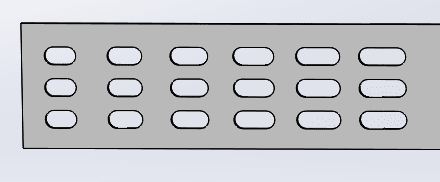

Do I understand correctly that you want something like this?
