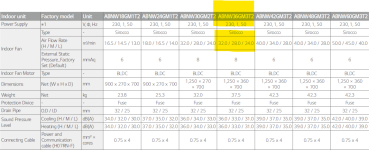

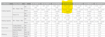

Hello everyone,
I'm troubleshooting a condensation issue and would appreciate any insights! Here's the situation:
-Load estimation: 10 kW (34,121 BTU/h) with an airflow requirement of 1800 m³/h (1060 CFM).
-Equipment: The customer has several concealed ducted indoor units, two of which recently started showing water droplets (sweating) on the casings.
Current Configuration:
-Outdoor Unit: 32,000 BTU/h rated capacity.
-Indoor Units (affected units): 1130 / 988 / 847 cfm (H/M/L) airflow capacity.
-Service Details: Technicians cleaned the filters, checked the condensate drain pan, and confirmed proper piping.
-Despite this maintenance, condensation still appears on the two units. I'm trying to understand if this could be due to undersizing or oversizing of the units, or if there might be other contributing factors.
Could an undersized or oversized setup be causing these condensation issues?
Might there be another underlying issue to explore?
Any advice or suggestions on what else to check would be greatly appreciated!

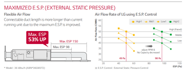

Hello, sorry for replying late.
It is Dx split system indeed.
Technicians did check the cooling coil and it's not clogged also they cleaned filters...
Outdoor unit : 16,030 / 32,000 / 38,000 btu/h
Indoor unit : Air Flow Rate 1130 / 988 / 847 cfm ; Max External Static Pressure ~ 0,609 inch wc
2 x Air terminals :
-Dimensions: Approximately 14.76 inches x 14.76 inches
-Airflow Rates: 294 / 406 / 559 CFM
The unit's load estimation : ~ 34100 btu/h and 1059 cfm
So the duct sizing based on 1130 cfm. Each air terminal with 565 cfm
Condensation is forming on the reduction and rectangular flexible duct connector and the space where the unit + ducting installed comes with curtain walls. The ducting installed between suspended ceiling and metal framework.
Ducting details : 2 x 45° rectangular elbow / Rectangular To Round Transition / 45° circular elbow / 90° round takeoff for one air terminal
Also the unit and the 1st reducer is located above an unconditioned space (wc).
I hope these details are enough
Attached is how the supply ducting looks like
Edit : I did not do the load estimation neither the equipement selection!
