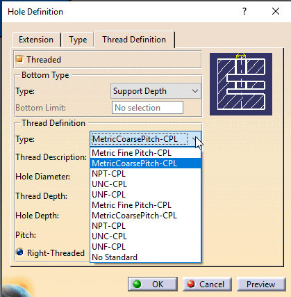

Duplicated standards in hole command
LucasC
Automotive
Feb 18, 2019
157
Has anyone seen this issue? It has shown up in R26 and now R29. I've gone through all the folders where the standards are kept and confirmed there are only 1 copy of each. I know there are at least 2 folders in the install that have thread standards, both were checked.
Update to this issue,
CATIA wasn't duplicating them. Our standards files are kept in a separate location, the software we use to serve V5 was reading the standards multiple times at launch and populating V5 accordingly.
