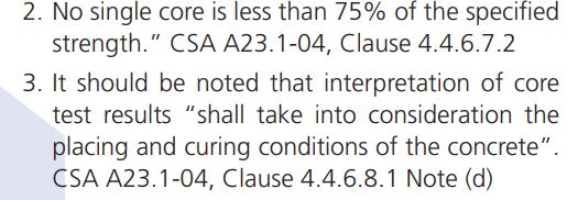

If you need something more authoritative point the inquiring minds to the relevant section of your code that allows field cores to be performed, and if in-situ average strength is > 85% of specified you are good to go as if the cylinders never failed in the first place. If people still balk at that have the lab also analyze it for the relevant durability characteristics directly such as air content. In Canada our governing code would be CSA A23.1 but I don't know where the similar out would be in ACI (excerpt from RMCAO industry best practice guideline below)
