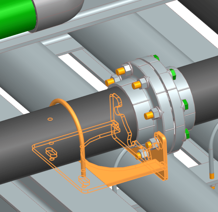

"Thrust Block" is not the correct term here. We are calling a weldment that we mount to the exterior of the pipe flange to react the thrust force as a "thrust block". I am not sure who came up with the name for the weldment, honestly. Here is a photo of one for reference:

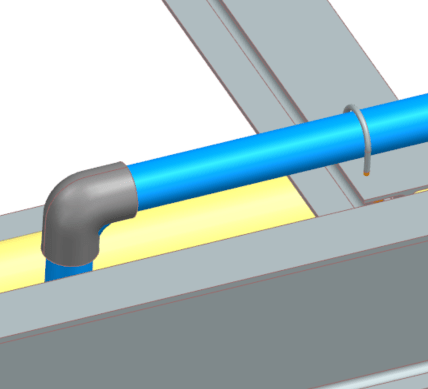

Your comment on pipe restraint has be concerned. My understanding is that u bolts are a fairly common pipe anchoring method. Is this not the case? I have attached a photo of a small PVC pipe with a u bolt drilled through the rack to secure the pipe.
This is fairly typical for what I am seeing in my 3D model.
Welded pipe or pvc glued joints do not come apart with thrust loads due to internal pressure or elbow momentum forces so you do not need thrust anchors. They are only required where the piping joints will come apart with thrust loads (like underground cast iron bell and spigot pipe). Your reasoning is correct though that the sum of forces would be the pressure thrust load plus the momentum thrust load at elbows as you indicate in your post. However for connections that can transfer load without coming apart, this force is transmitted axially through the joint and piping and equalized by the same elbow force at the opposite side of the run of pipe.
The u-bolt you show only restricts pipe from moving laterally. It also restricts small piping from moving axially but large pipe will slip with u-bolt if load is heavy enough. Sometimes if you want to stop some axialy force with u-bold sometimes a lug is welded to the pipe at the u-bolt but this is not done when significant forces are involved. Proper anchors or axial would need to be designed for significant forces.
I don't think the u-bold weldment thing you show performs any function whatsoever because it is attached to the pipe itself so it moves with the pipe. If au-bolt is to provide restriction to movement it must be attached to the structure that the pipe is supported on.

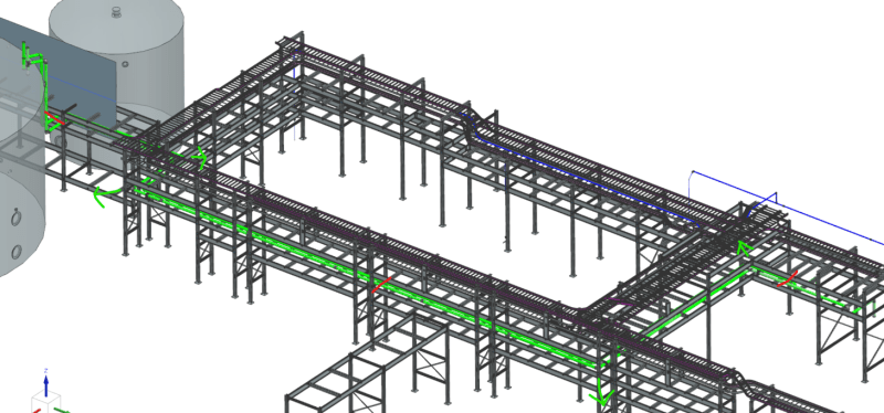

Perhaps the image above is not the best to properly portray the use of the u bolts, here is an overall of a single route. Y axis is roughly 160' and X is roughly 53' with the green being the pipe.
Our thermal expansion should be minimal as we are in a heated building and fluid temps are not to exceed 100F. My understanding of the placement on this pipe (very official red lines drawn with MC paint represent U bolt locations) is that we are hoping the thermal expansion we will see should be absorbed by the direction changes. Now that I say that though, if we anchor the pipes with u bolts there wont be much space to grow or shrink..

The weldment I showed in my previous post is actually secured to the rack using the u bolt. We drill holes into the rack for the u bolt to go through and then bolt it to the flange. The picture is a little hard to follow so my appologies for that. The top of the plate actually mounts on the underside of the beam flange.

Good god, who located those "anchors there?
Going from the left, the first one maybe, no 2 should be at the midpoint, nos 3 and 4 need to go and no 5 prob moved back towards the tee. but do a stress analysis on it. PVC is a brittle material and can snap before you can see it is over stressed. The vendors often have good manuals or ways to do things that we wouldn't have thought of. They may even supply inline bits which allow you to anchor the pipe.
U bolts are designed to hold pipe stanchions to steelwork or fix things like instruments to a circular pole. They should never be used to clamp pipe which has an axial thrust to try to stop it moving. Just results in failure.
You can fit a pair of flanges and then clamp the flanges using the bolts or fit a thicker section and then clamp two half shells around it with some slightly squashy material between the clamp and the pipe.
U bolts could be used as guides and vertical restraints, but the the risk is someone goes and clamps it down as they don't understand why you wouldn't, so better not to use them at all IMHO.
On your flange clamp thing just throw the U bolt away - does nothing for you and again someone will screw it down.

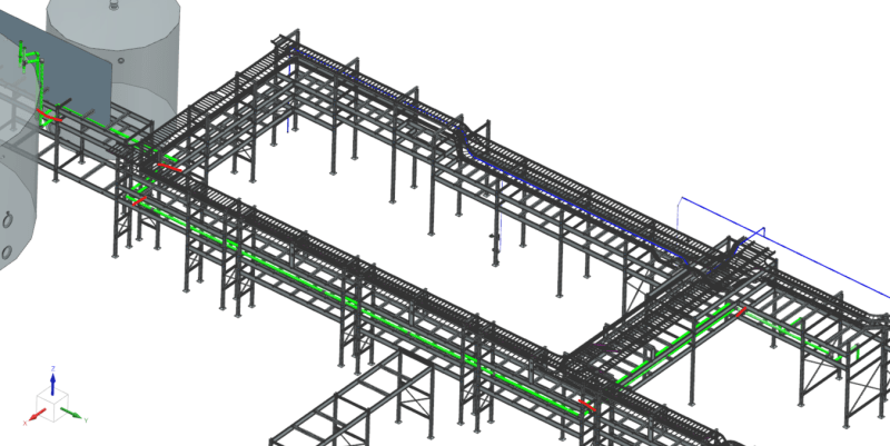

My gut tells me to do this:
Anchor at the ends and one in the middle. This would allow freedom to move in the direction if the green arrows. Please note, no Z movement . Placing the anchor in the middle of the long y run would essentially turn the two halves into a couple expansions legs. I am expecting 1.46" of expansion in both the pos and neg Y in the longest Y axis leg with the anchor. If I anchor it in the middle, I can control the expansion to go to the corners. Does this logic pass your gut test? I will look into running some pipe stress calcs here shortly.
Also, I totally agree about losing the u bolt on the flange clamp. Not sure why those were originally proposed.
As a first pass looks ok to me to go and see what the stresses / movement are in your elbows.
That short leg on the left is a bit "stiff" looking though. You might need to move the line stop / anchor closer to the left to reduce the amount of movement coming into the short leg of the Z. Ideally it should be located where the stress program shows zero movement if you analyse it without an line stop, only a guide.
Others may have a different opinion. An experienced pipe stress person will sort this in a few hours.

Is the green line in your screenshot the 12" SS piping? If so then I get a thermal expansion of the longest "Y" run which appears to be 120 ft long at 0.6 inches maximum. This assumes installation temperature of about 60 F and 40 F for differential temperature for thermal expansion, with alpha SS = 11x10-6 which is conservative. For this line I would put a limt stop or anchor in the middle of the line run where you show it moved to now. This would minimize the loading on this anchor. Most of the loading on the anchor is when the pipe starts thermally expanding and then the force on the anchor will be the friction force due to the normal weight of load on the pipe support times the coefficient of friction on the support. The dirction of the friction load would be opposite to the motion and towards the anchor. By locating the anchor in the middle then equal friction loads with exist on each side of the anchor pushing on it and balancing out for minimum net load on anchor. An anchor in the middle will allow thermal expansion of the long lenghts into the elbows/change in direction at the ends. So putting the anchor in the middle of the run you would get 0.3 inches expanding into the connecting runs at the ends. I would also install guides about every 20 feet on the long run to prevent sideways movements and take any sideway loads such as earthquake. I would not put any guides or restrictions with 10 feet or so of the elbows as to not restrict thermal expansion from perpendicular pipe legs. The actual minimum distance of elbow to guide can be checked with stress analysis or with estimated pipe stress methods such as the guided cantilever beam method.
It looks like the short "X" run at the left end where the pipe turns is about 10 ft long with negligible thermal expansion of about 0.05". This 10 ft offset should well enough to take 0.3 inches of thermal expansion. I would put a guide in the middle of this run with a 3/8" gap. This will allow the long pipe run to expand into it but keep some restriction on lateral movement.
The next "Y" run going towards the tank appears to be about 20 ft long with negligible expansion of 0.1" approx. I would put a axial line stop or anchor in the middle of this line with guides also placed but again not too close to elbows. This will provide both lateral and axial movement limitation at this point. With this section fixed and the other long "Y" run fixed with anchors/stops in the middle an with guides also included, the entire piping system will be fixed in both "X" and "Y" directions.
I would not put any vertical restriction on the short "X" run before the vertical up to the tank nozzle. If tank themally grows vertically due to temperature any vertical restriction on that short run will overstress the pipe. I would just put a bottom support with guide and 1/4" gap on guide. You may need to check the load on your tank nozzle with this arrangement considering that if the pipe starts lifting off the support on that short run, it will put the weight of the vertical pipe run to the top of the tank all on the tank nozzles. There may need to be a support on the vertical run of pipe to keep load off the nozzles and/or nozzle may have to have stout reinforcement pad installed.
Looking at the other end of the system the perpendicular run to the long rung to the right which appears to be about 40 ft. long, I would put an anchor/stop in the middle with guides also installed on this segment to within about 10 ft more or less of the elbows with 3/8" gap. This will allow for thermal expansion of the long run, allow for themal expansion axially of this short run, and provide restriction in both the "x" and "y" directions.
For the last "Y" run to the right which appears to be about 20 ft or so long again I would put an anchor or axial stop with guides in the middle of the run and install guides on other support to within about 5 feet or so from the elbows since not much thermal expansion is going into this pipe.
I would then check with a piping stress analysis program and adjust as necessary. I use Caesar II mostly but have used autopipe. Autopipe is mostly what is use in waste water treatment systms for some reason.
