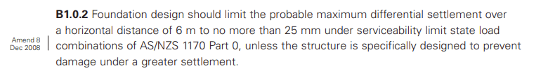

The Building Code here has a requirement to limit deflections to max 25mm over 6m under serviceability conditions
To be honest, that seems like a pretty high limit, I'd be quite miffed if my house was 25mm out, but that's what it says...
My 2c on these highly fudged methods - conventional residential construction has plenty of ground clearance so the absolute magnitude of settlement is not super important
Differential settlement is far more important
Modern foundations typically are so stiff and strong that, unless you're sitting on highly variable soils, the foundation should be able to redistribute the loads and constrain differential settlement
