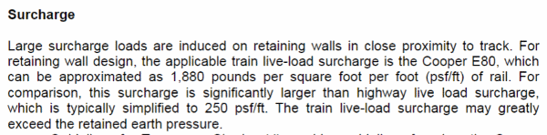

Looking for commentary about the design of retaining wall (abutment wall) for rail loads from E80 Cooper engine when rails are perpendicular to the retaining wall …..not parallel.
Alan L. Lumpkin, MS, PE
Greenville, SC
I've considered the E80 loading to be an 1880 lb/ft2 surcharge that starts at the wall but only covers a length of wall equal to width of the ballast (say, 10' +).
Loading magnitude (1880 lb/ft2) from: AREMA's "Retaining Wall Design for the Railroad Infrastructure"

OK guys.....I get the 1880 psf load as surcharge load and I also agree with that number. Now moving towards design, the load cases as defined by AREMA are as follows:
1.4(DL+5/3(LL+I)+E) …...there ia no impact on soils loads per AREMA CHAPTER 8 so that leaves the equation as 1.4DL + 1.4*5/3*(LL)+1.4E. Continuing...1.4DL + 2.34LL +1.4E. So, here's the question. That puts the soil load at 1880 psf * 2.34 = 4399 psf surcharge. If I assume an at rest pressure coefficient of 0.5 then the pressure behind the wall is 2200 psf.
Let me know what you think as these loads are then used to design the abutment/retaining wall.
Greenville, SC
Agree that the lateral pressure from the live load surcharge, using your assumption for Ko, is 2200 psf. That value is not soil load, it accounts for weight of the train. To design the abutment/retaining wall, lateral earth pressure and hydrostatic pressure from ground water (if any) need to be considered at the same time. IMHO, each of those loads would be treated as dead loads. Earthquake load (appropriate for project location) should be included also.
[idea]
Make sure that you check if Ko is required for your particular structure or if Ka is allowed. For sheeting walls, I always use Ka. Also, AMTRAK, for instance, requires adding a 50% LL impact factor on top of the Cooper E80 even though AREMA may not require impact. Check if your particular railroad (or railroads for shared tracks) require impact.
The railroad abutment usually is quite bulky, I opine at rest pressure is more likely to develop into. Make sure the information provided by the geotechnical report is suitable for factored load design method, or LRFD, so no "doubling safety factors" will occur.

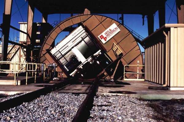

Does anybody know how the rail track behaves when across two mediums with drastically different stiffness - from soil to rigid abutment? How this situation was handled?
It's not a big problem, but has to be addressed on a regular basis. The following photo is from the web, but shows one of our coal car unloaders (I recognize the setting)
This pit founded on rock, with vertical sides and is over 80 ft. deep, 75+ ft. below the water table. The (welded) rail is on typical RR ballast all the way up to the side of the pit. In coastal SC we have deep poor soil, so all of the track is slowly but continuously settling. As the ballast settles the welded rail cantilevers away from the (non-settling) pit and slopes down over a horizontal distance of, say, 6 or 8 ft. The drop in elevation is very easy to see after a year or two but does not cause problems. Every two to three years we bring in a RR contractor to raise the grade of all of the track on the generating station site. Special equipment moves along the track, lifting it (including attached cross ties), "crams" more ballast under the track, and reset the track to the higher grade.
