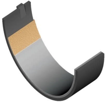

For the E90 bearings, it looks like they use a surface treatment, WPC, to improve load carrying capacity. Journal bearings wear during engine starting and stopping. It's possible that the bearings don't have sufficient load carrying capacity once the coating is gone. From what I see the treatment is only 5-20um thick.
That's the 4.0 litre S65 V8 non-turbo engine. I know nothing specific about those, other than that BMW does not do V8 engines well. They do inline sixes better.
From the end-user point of view (1) buy something else, or if you are stuck with one (2) follow oil change recommendations religiously, both concerning the intervals and the viscosity and specifications, and (3) avoid the driving conditions in which rod bearings are most heavily loaded ... low revs and high torque (lugging), and high engine load near or above redline, and operation with high oil temperature.
Minor investigation finds that this issue is common enough that the aftermarket has what they claim is an improvement:
They claim that the OEM setup has too little oil clearance. I have no specific knowledge about that specific application ... but too-tight rod bearings can certainly lead to trouble.
Different vendor similar description of problem
BMW recommends 10w60 oil for these. Wouldn't surprise me if an oil change at the generic auto parts shop around the corner leads to the wrong oil being put in, followed by badness.
Wow. 60 wt oil in tight-clearance bearings!
