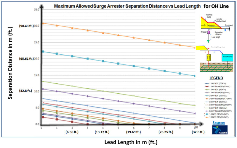

In absence of any data and guessing from the picture originally posted, it appears the primary voltage ~138 kV with a larger lead length assumed <30ft (12' Btwn arresters & 18' for down leads). A rough estimate from the graph below provide a max. allowable protective distance from arrester to the transformer >20'. Since the arrester is adjacent to the bushings, most likely the arrester effectively will protect the transformer again lightning surge.
Until better data became available, the preliminary conclusion is that the lead length is not excessive and the arrester could provides an acceptable degree of protection.
For reference see also the enclosed thread.
