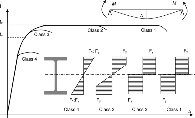

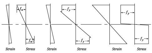

steveh49, good point. To illustrate your comment, let me take bring back Yao1989's comment from this thread
Yao1989 said:
My understanding is that class 1 & 2 are thick enough such that you can continue to allow high strain, and allow the extreme fiber to continue to deform past yield until the entire section above/below the neutral flange has yielded, thus all loaded to at least yield strength, hence you can use plastic modulus. You don't do this for class 3 & 4 because they are too thin and will buckle locally after the extreme fibers are past yield stress. In fact for even thinner sections you'll see on cold-form-steel, local buckling may govern the section before you even reach elastic yield of extreme fiber.
Source:
If my understanding is correct, since welds can't sustain high strain, the stress will be higher at the flange than in the web of an I beam. So the method I have shown can't work with class 1, 2 and 3 sections, but can work with sections of class 4:

The strain in flanges vs web is a good discussion, but not sure where the idea of "...since welds can't sustain high strain..." came from.
Unless you have a highly restrained joint (i.e. triaxial restraint), the welds can indeed sustain high strain - at least for mild steel and HSLA used in structural steel along with just about any decent toughness filler metal.

The only way your method would work would be if the member capacities used for your utilization value were just a check that the stress does not reach the yield stress. Your capacities, though, are likely based on the plastic capacity where the edge of the flange reaches yield stress at about 85% of its capacity. If you have buckling issues, then the capacity may even be for a stress that is less than the yield stress. There's also likely some additional weld capacity available if you account for the load direction and strain compatibility.

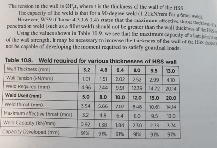

For conservative estimates of fillet welds (which I also use all the time even as a fabricator) I simply use 0.933 kn/mm for 6mm fillets and ratio based on leg size for anything else. Also, to develop HSS section strength via fillet you can find a table in "Structural Steel for Canadian Buildings: A Designer's Guide" that correlates leg size to HSS thickness to develop it (I can post it later if you want, it's at the cottage right now so I don't have access).
Ok thanks! That looks good enable. I would be glad to check this reference.
