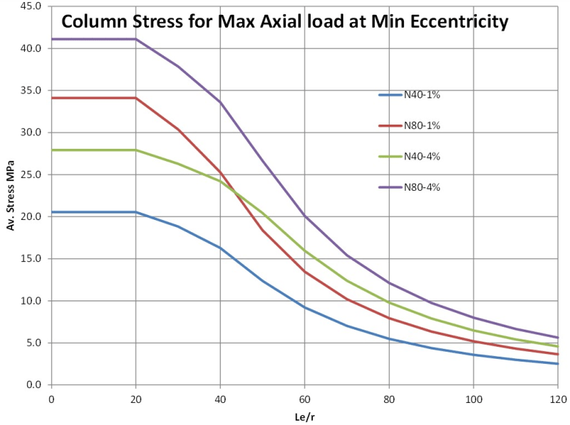

I believe forum member IDS produced the following chart (AS3600).
Notice how slenderness effects kick in at Le/r = 20.
