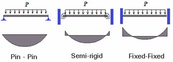

I will suggest the use of in-between case for beam - column joints ; semirigid connections. The semirigid conn. modelling creates lighter frames. The reason is that , the overall maximum moments in beams decrease by comparison with the moments of rigid frames for hogging moments and decrease the sagging moment which is max. for the simple connections , thus smaller sections can be used.
However the semi-rigid connections cause a large increase in the frame drift if the bld is not braced. I thing this thread discuseed in past several times , one is , thread507-461579.
I found the pictures from web search which is useful to see the concept.
That looks great in theory but creating a semi rigid connection to perform in a reliable, quantifiable and code justifiable manner seems quite difficult. But that is something I'll look at for my own curiosity, but I don't see the benefits to complicate things too much for this type of application.
