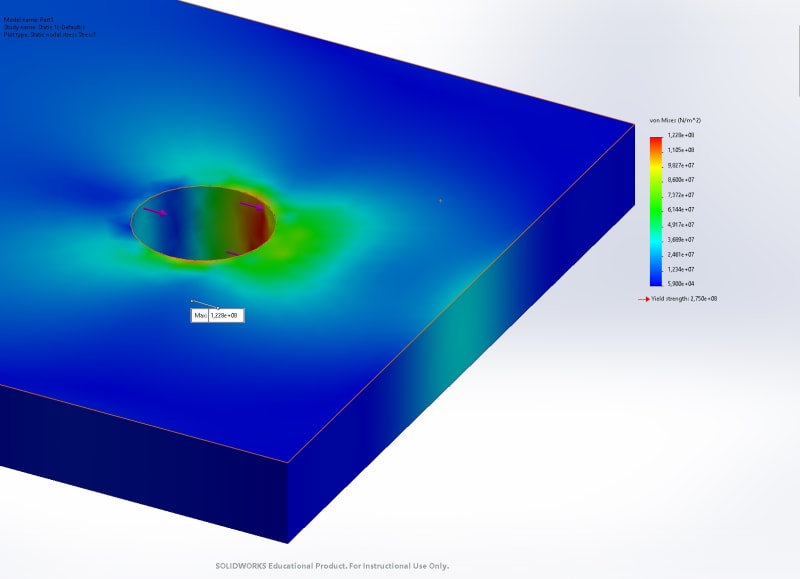

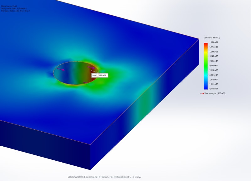

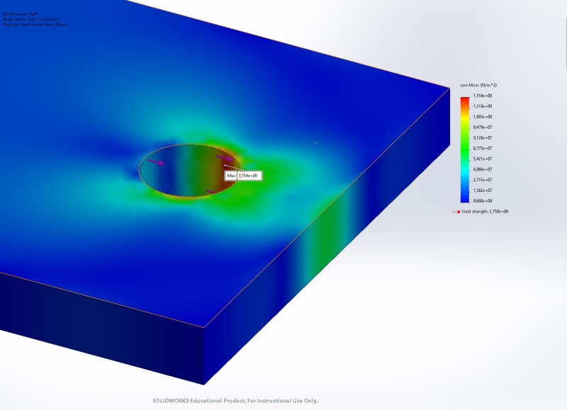

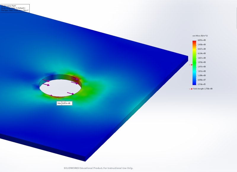

Thanks for your comments.
I did a simple static SolidWorks simulation, this does show that ED has a greater effect on the thinner member of the joint.

Well, then the theoretical answer remains "no, there is no published data". And a FEM is unlikely to correlate to actual strength data (I've been down that road into the swamp).
the only reason to worry about the 0.025" sheet, compared to the 0.125" thk sheet/plate, is if the load is coming from one element into the other. Then obviously the 0.025" sheet is critical. Otherwise, if the 0.025" sheet is "supporting" the 0.125" plate, then the 0.025" is irrelevant ... ok, not irrelevant but a very small part of the solution. Low eD on the thin sheet would reduce the small load that the thin sheet can carry, compared to the thick plate. Probably easiest is to ignore the thin sheet altogether.
I am seeing fastener bearing in the FEM... but no fastener RADIAL interference [hole compression] stress/strain.
