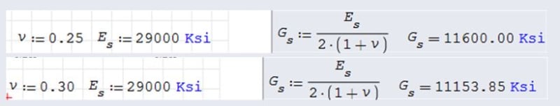

Due to going through a Dunning-Kruger drop in FEA confidence I'm starting to question some of the basics, like how important is getting the poisson ratio correct when using bricks and shells?
The Ausy steel code AS4100 states to use 0.25 but most literature I have read states poisson to be around 0.3. I know I could do a sensitivity analysis but with 3 + hour analysis run times, I can't justify the extra runs when our day to day hand calc's don't consider poisons ratio (treat everything a simple or encased beams)
Can I please have some advise on when changing the poisson ratio has significant effect's on anaylsis results. i.e. over 3 significant figures.

really good question; it's generally taken as 0.3 in any foreign codes I've been involved with. I should have added, it has a big impact on Shear Modulus.
Poisson's is interrelated with a number of other factors, but those factors are often called out separately, hence my suggestion to ask the FEA maker what they use it for.

Anyway, is that make any difference if I use 0.25 instead of 0.3? For 1% tensile axial strain of rectangular bar with axial tension, the lateral contraction strain would be 0.25% instead of 0.3%. This means the lateral strains and lateral stresses are less than 16.7%. For multiaxial loading, further less in multiples of 16.7%. So IMO, not conservative assumption.
I suspect minor, but as noted, it has an impact on the Shear Modulus which may be of more significance with FEM.
