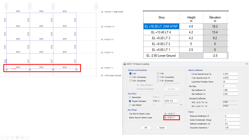

When I compare the ELF analysis by ETABS and hand-to-hand calculations, I found a differences, in which although I modeled the tie beam, ETABS does not read the tie beam as effective weight, as to my hand calculation I did. Therefore the seismic weight of my hand calculation is bigger. But I think the seismic weight doesn't include tie beam/sloof in it's calculations. Correct me if I'm wrong

- the tie beam at the foundation level moves with the ground during an earthquake, so its mass does not produce effects on the structure. For the same reason we don't include the mass of the footings in the seismic mass. If you do so, you will never be able to mobilize that mass, no matter how many modes you include in your modal analysis.
Oh - I hadn't read above - my mistake. If the tie beam is at the base of the structure - it wouldn't be considered
So I get the conclusion that in that example above, the tie beam is not included in the effective seismic weight. I modeled an example of a simple building, with a basement but I didn't modelled the basement. I start my model from the 0.00 elevation as you can see above. My question is, in the bottom story for seismic load, should I input it as El. -2.5 (the base) or as El. 0.00???
**Elevation -2.5 from 0.00 was meant to be a basement
