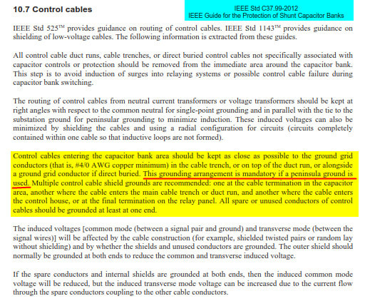

Does anyone know how effective is a set of Grounding Cable over a substation trench next to a 230 kV 200 Mvar shunt capacitor bank to mitigate transient voltage protection of shielded control and power circuits?
The picture below shows a propose ground cable installation. Please advise.
It's very effective. Without out you'll blow up a lot of relays taking in feeds from CVTs during disconnect switch operations. I would even suggest that the grounding conductors should be located more centrally in the trench, as opposed to being strapped to the side. You want any cables in that trench as close to the grounding conductor as possible. The shielding properties of the cable shields on the cables running in this trench are directly proportional to the physical area between the shields and grounding conductors.

Below is a recommendation from the IEEE Std 99 regarding the use of ground cable on the trench particularly for Cap Bank peninsula grounding application.

I am taking the liberty to use an excerpt from the IEEE Std 525 (Guide for the Design and Installation of Cable System in Substations) to indicate the benefits suggested.
Based on the enclosed IEEE recommendations, it is our opinion that installing grounded parallel conductors along the trench and the use of breaker POW for zero-crossing (Synchronous closing Control) will add extra safety assurance to mitigate the effect of transient switching induced overvoltage on the existing shielding grounded conductors.
