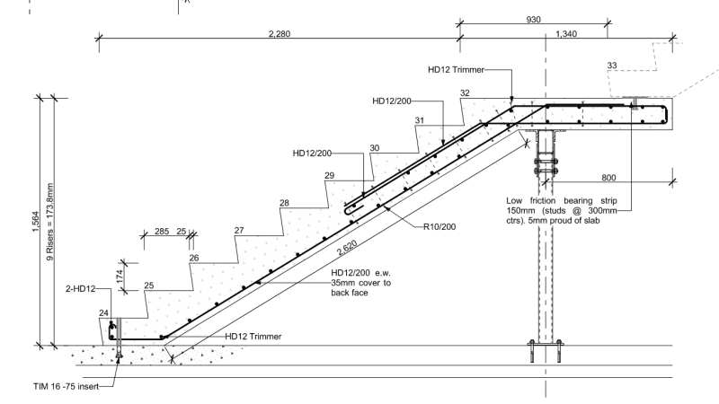

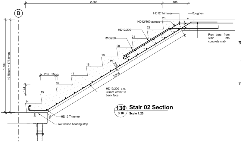

I would detail for slip all day long, it's so easy
If you don't, it's a double whammy of having to detail your stair to take a potentially huge axial compression load, and also to design your building for the impact of these random tension-compression struts that are probably in awkward places
Here are two stairs that I've designed that show options - 1 is pin based and sliding at the top, the other is fixed top and sliding at the base
P.S - bonus points if someone can figure out what I very nearly fucked up in the first Detail.... it's not related to sliding
