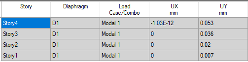

Dear Mr wcfrobert,
Thank you for your reply, sorry if I didn't clarify in my previous post, actually everything is exactly as you said, I mean I do have a symmetrical building, what I'm looking for is an eigenvector with four components each one belongs to each floor, however, when I was checking in the software I found the displacement of each floor ( after considering the center of each floor on the middle by diaphragm option) but the issue with me is how to the transfer the displacement vector to the eigenvector?, in the picture below is the output from the software for the displacement vector.

I believe the displacement vector IS the your mode shape vector (phi).
The eigen vectors provides the relative "shape" of each mode, the magnitude does not really matter and can be anything as long as the relative shape is maintained (i.e. it can be normalized a number of different ways)
When doing hand-calculation, the vector is often normalize such that phi(1) is equal to 1. In your case: {1; 0.68; 0.38; 0.13}.
Most computer programs compute the mass-normalized shape vector, where {phi}[sup]T[/sup] * [M] * {phi} = .

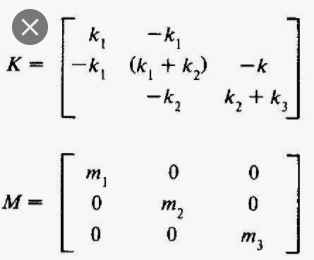

You can find the mass and stiffness matrix of a shear building pretty quick. The mass matrix is the just a diagonal matrix with mass of each floor, and the stiffness matrix is another diagonal matrix with band width of 3 (with pattern similar to below)

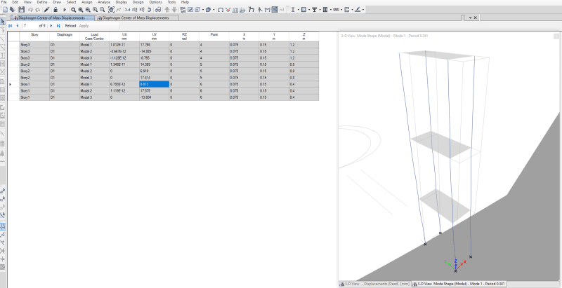

Thank you for replying to me back Mr wcfrobert,
As far as I understand from your comment that in order to get the eigenvector (the one that we derive from the eigenvalue problem), I have to normalize the displacement vector, as you mentioned {1; 0.68; 0.38; 0.13} so this one is the eigenvector for the first mode shape, am I right for getting your point?

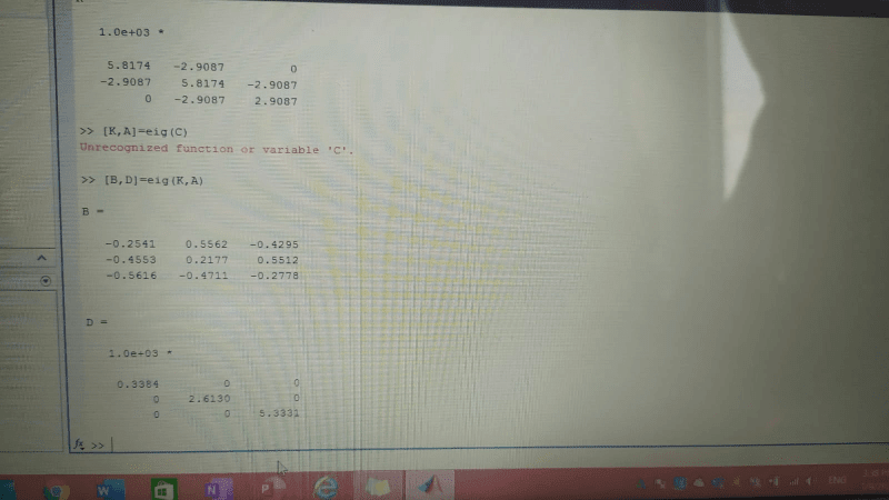

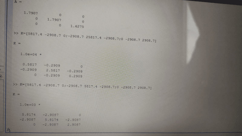

I did a simple hand calculation of three stories frame structure and I checked the values of the time period and I got the same but when I compare the value from the table of diaphragm center of mass displacement after normalizing them, it does not give the same result.
this is the eigenvector from Matlab,
and this is the work from Etabs
and after normalizing them I got V1=(0.733 0.594 0.3308 ) V2= (-0.619 0.28776 0.7309) V3=( -0.3687 0.7325 -0.572)
