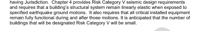

You asked about referenced documents. The U.S. Government has certain buildings that it tries to keep the system elastic but there is some more to it than just the R value and importance factor. This document, that says it is canceled, is actually still being referenced for the Category V structure designs by the one that superseded it. I have never designed such a building but I have used R=1 and I=1.5 as part of the seismic rehabilitation for an existing structure where it had a very unusual existing system.
