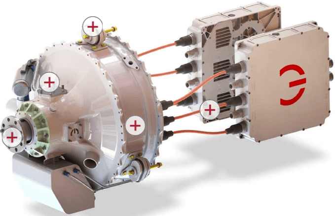

Does anyone know the state of the industry for aircraft electric motor development, globally? I'm referring to full size aircraft, not models or small drones. I know that the internet has information, as an example, Rolls-Royce set out three years ago to build the world’s fastest electric aircraft—teaming up with two U.K. firms: the Daimler-owned automotive supplier YASA ( and aerospace engineering startup Electroflight. The aircraft was propelled on its record breaking runs by a 400kW (500+hp) electric powertrain. I'm trying to find out what the state of the art in this field is and who the manufacturers are. Thanks for your help.

Thanks WindWright and LionelHutz however, I would like to focus on the electric powertrain used for the aircraft (axial gap, radial gap, PM, induction, SyncR, etc.)and the current existing manufacturers of these motors. Also, the advantages and disadvantages of each technology.

magniX motor supplier cited at the link for Harbour Air has pictures and specs on the website, but other than s reference to the components being water cooled, construction is not published.

Thanks WindWright. I agree, I should have provided more background. I have done quite a bit of on line research. I was aware of Eviation and Magnix as well as Magnicall, Rotex electric, T-Motor, Safran, Rolls Royce-Siemens, Archer, MGM Compro, and several more. The issue that I'm facing is that they don't go into much depth about the technology being implemented. I have found that Rolls Royce is using an axial gap BLDC (YASA, two in tandem), aside from this the information is not readily available. I'm reading EVTOL in an effort to gain some insight. I have reviewed several papers ie; ELECTRIC VTOL CONFIGURATIONS, A NASA PERSPECTIVE ON ELECTRIC PROPULSION TECHNOLOGIES FOR COMMERCIAL AVIATION, IEEE, and more. Some manufacturers offer data sheets however, I feel that they are somewhat driven by marketing and they do not offer specifics. What I'm interested in is the technologies and the pros and cons of each approach. I find Keith's comments about superconducting motors and links very helpful. I design electric motors and I would like to be prepared should I have to design motors for aviation propulsion applications. I have designed motors for radio controlled quad copters however the scale is much different from passenger aircraft.

I've seen similar things develop in electric aviation, even though I'm not tracking this subject as closely as you seem to be. Electric "traction" motor technology has a lot of varieties; there's no clear winner yet in any given application. You also can't separate the motor from the control any more, and the architecture of the motor drive unit is probably the most tightly held secret. It wouldn't surprise me at all if the Eviation engineers are still NOT permitted to open the drive unit boxes yet, even though eventually a certification spec will have to be generated.
If you want to get a flavour of the various technologies that are being used in traction motors, you can always look deeply into the automotive sector, where a lot more information is available. Lots of well documented EV automobiles with service and maintenance manuals, troubleshooting guides, and even DIY modifiers taking them apart to re-purpose the drivetrain for conventional auto conversion projects. They crack the CANBUS, make custom interfaces, integrate the chassis and presto they have something like an RX-7 body with a Tesla drivetrain. Some of it is just to climb the mountain "because it's there" but it also reveals a state of the art at multiple levels.
I am not convinced that the technology being used in electric aviation is any different from the technology in EV autos, although Itsmoked's hint about superconductors makes me question that. The big players could deal with that complexity. Looking at the other end of the scale, there are a lot of small start-ups developing electric propulsion for aircraft, and not all of them are just scaling up toy drones to a size big enough to carry a person. The scaled-up drone messaging seems to come from hobbyists who have no idea what aircraft certification is like. There are some notable exceptions from developers like Ampaire, Lilium, and Eviation that seem to have both funding and technical depth to get somewhere with their concepts. However I don't think that these particular aircraft are benefiting from radical technical leaps.
