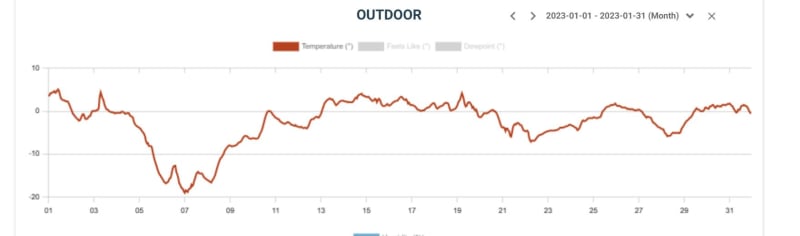

Here is my local temps this year in Jan.
I had to rescue some one on the 7th who's unit snowballed and didn't have enough energy building internally to complete the defrost cycle. The local solution when it happens is to take a propane burner outside to the heat exchanger and melt the ice off. I got him to light all the wood fires in the house and get the temp up to 20 degs in all the rooms. Turn on all the multi indoor units and give the defrost cycle enough energy to work with. Took the house temp down to 15 degrees doing it,

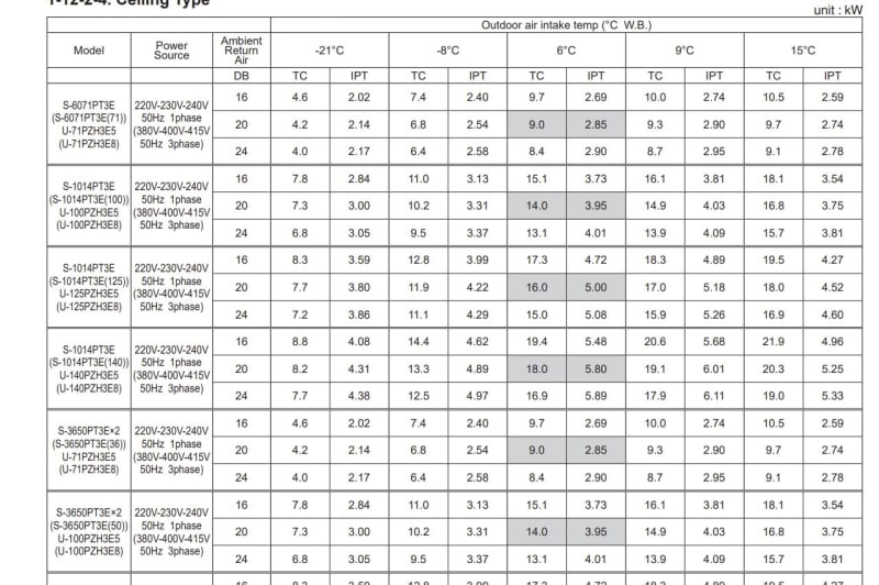

When I was doing the specifying for my place the 10kw unit had an output at the min specification temp at -21 of 7.3 kW with a current pull of 3 kW at 20 degs internal temp and 7.8 kW and pulling 2.84 kW at 16 internal. Which is more than 2 COP.

As you can see though you're getting half the heat power compared to 6C, but losing double the heat. Result- the building will get colder.
Now a workshop it might not bother, but if it's your apartment then you need to supplement the heat input just as the heat loses go up.
Also would be good to know if those figures allow for the reheat cycle at lower temperatures? So 7Kw, but only for 70% of the time??
That's why you need additional heat.
You just need to spec it for you min output at your min design outside temp. Which is what I did.

No I have taken my required thermal requirement at -21 outside with an inside temp of 16 which requires 6.4 kw according to my heat loss calcs for the building so could manage about 21 internal if I want. The pump will put out 7.8 kW at that differential with a pull of 2.84 kW. And yes its DC inverter so variable output not on off. MIn output 3 kW with a pull of 0.5 kW at -10. I will more than likely have 1 start cycle between end of Nov and start of April.
