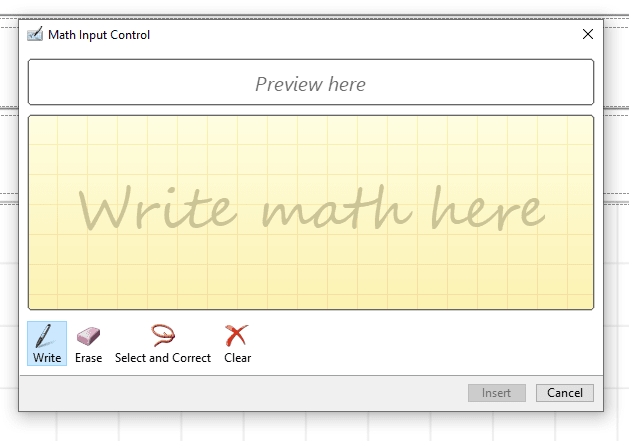

I believe word and one note have exactly the same equation to text feature, this one?
One note will calculate a equation if you were to write 3+3= and hit return it would enter 6 as the answer.

back on topic... if I convert the PDF to an SVG file format image you can import it into word with no quality loss.
The only issue is you need to stuff around with section breaks so you can adjust margins for the page you insert it onto in word to accommodate expanding the image to the full paper size. Easy enough to automate this though via some macros I suppose (click a button an all the necessary steps are taken). But it's the only way so far I've found to bring a single page PDF into word with satisfactory results. Haven't tried multi-page PDF yet.

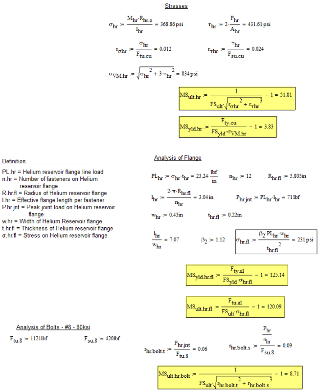

+1 for Mathcad and SMath Studio. With both programs, the math is visible and easy to follow* (unlike Excel), and units are handled beautifully (unlike Excel, which doesn't do units natively). This makes debugging and verifying a calculation procedure many times easier than with Excel. It's also easier to annotate calculations in Mathcad and SMath. Both programs provide quick and easy recalculations for new data (just like Excel). Hand calcs are visible and easy to follow*, but units require manual intervention and recalculations are time consuming.
*Assuming the engineer does a good job of organizing the calculations.​
Of the two, Mathcad looks better, but SMath is free. I have used Mathcad since the late 1980s (starting with v2.5.2, the last DOS version) and SMath for maybe ten years. I prefer Mathcad over SMath, but each program has its advantages. Also, both programs support document templates (like Excel, Word, etc.).
The beauty of electronic calculations, whatever the source (e.g. Excel, Mathcad, SMath, etc.), is that that the calculations can be reused for new projects without having to start from scratch each time. Sometimes, only the data needs changing and other times portions of the calculation procedure need to be changed, but in any case much time can be saved. The most impressive time savings come from repetitive calculations where only the data changes. On the other hand, when reusing calculations, it is imperative that the engineer verify all inputs and verify that the math procedures are correct.

I tried Mathcad several years ago. I found it would be easier in some aspects but more cumbersome in others, especially when dealing with large tables and the automating of repetitive calculations that I do with macros in Excel. My preference for Excel is probably mostly a matter of familiarity, though.
There are options for embedding Excel tables inside of Mathcad, which then allows you to set up the calculations relatively easily.
One significant advantage of setting up re-usable worksheets is that things don't get lost, and you won't "forget" to do some special case, since it's already in the worksheet.
