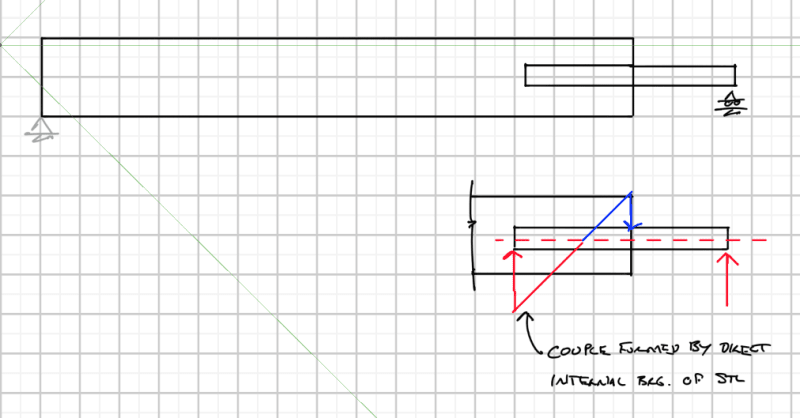

Is this an accurate depiction of the condition, where the embedded steel element serves as an extension of the slab to a support?
If so I see the force transfer requiring internal development of compression bearing stresses to form the couple required to have the steel act as an extension of the slab. A Strut-and-Tie approach may be appropriate in this case.

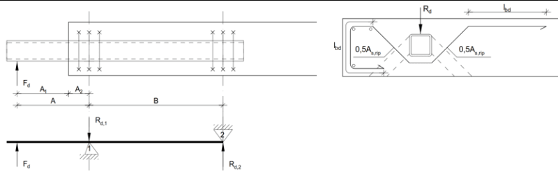

Yes, this is the case. Basically it is solved like a simply supported beam with a cantilever part. Then reinforcement to hang the tube to the slab reinforcement designed for the support reactions of the notational beam. The end, but...

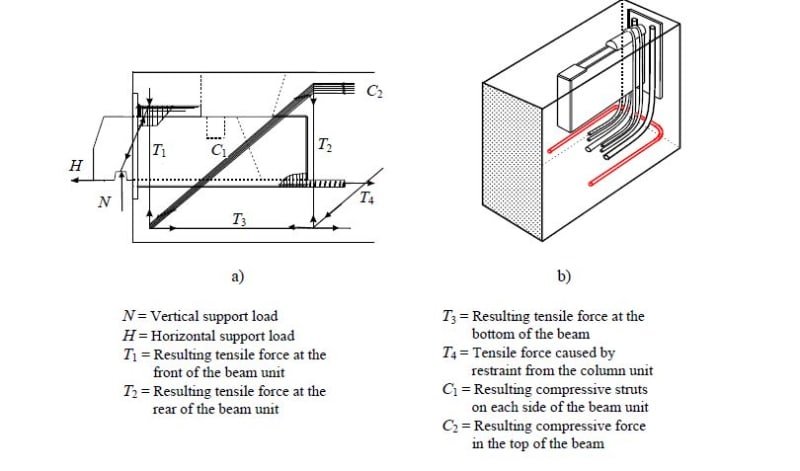

The following is excerpt from ( Structural connections for precast concrete buildings FIB -CEB Bulletin 43)

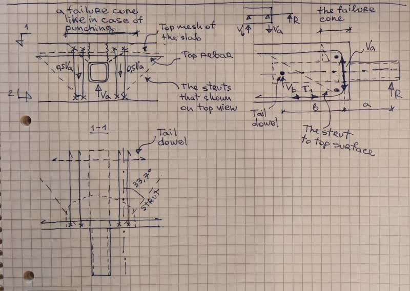

I have thought about a truss model 1st, but stuck in some places. Will try to present it

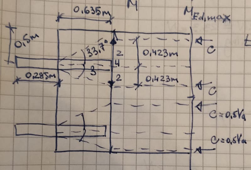

1. The slab is missing stirrups, thus "classic" distributions of load when each strut hanged by a stirrup is impossible. So I have assumed 2 fan shape struts from top to bottom corners.
2. If to look from top compression stresses should flow to the tubes. Have taken the 33.7 degrees angle of the strut inclination from Eurocode recommendations for anchorage zone of post-tensioned tendons. Somehow need to hang bottom reinforcement of the slab to the tubes.
3. Something like that as a local model. It seems to me the edge should fail similarly to punching failure. Dimensions of the cone are unclear. Seems to me the top rebar passing through the edge U-rebars should be massive or many rebars with small step. Somehow to check that the block straight above the tube will not fail with vertical edges (the failure cone will be formed). Maybe need to make direct contact of the top rebar to the tube to avoid transfer of compression by the concrete in-between.
