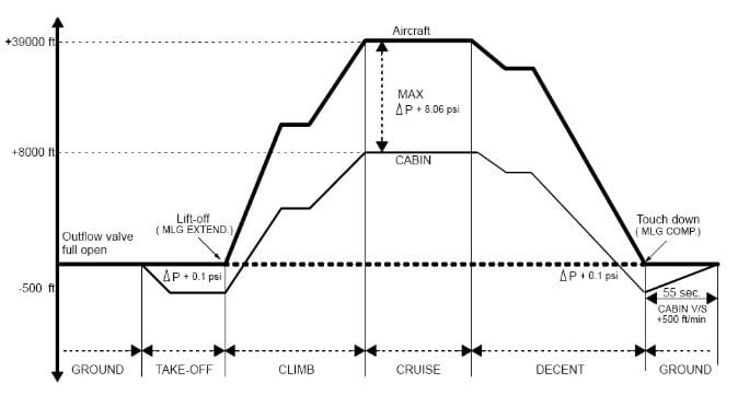

found this off an aviation site discussing it.
Its the cabin pressure profile.
The ground phase I believe is mainly done by the hull condensate dump valves. There is sometimes issues if the aircraft operates in sub zero conditions for days because the condensate internally never melts and the dry operating mass can increase quiet dramatically. And when you then go somewhere warmer a lake forms under the aircraft on stand which alarms the ground handlers.
differential_pressure_in_a_fuselage_during_flight_phases_f94100f13d47f3cc722ce2106328dbef11fc9c29_zb44gd.jpg
That is one confusing way to produce a graph. Turn it upsidedown and it will make much more sense.
That graph is almost certainly aimed at aircrew, who think of cabin pressure in terms of altitude, rather than kPa / psi. They do use psi for the differential pressure, but altitude is the one they actually set on the pressurisation panel. You can see the relevant panel on a 737 here:
It is historic, and regulations.
Everything centers round 10 000ft and oxygen provision.
It would be extremely complicated if it was any other method. Aircrew have a history of mucking pressurisation up as it is with a guage with red yellow white yellow red. Or digital numbers changing colour.
