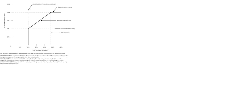

See if this helps, UFRO is also called V/Hz in some AVR's,
MikeL.
With the monumental lack of focus it's not a good example of anything.
But, for a 50 Hz generator the setting that I am used to is 47 Hz.
Seeing a voltage drop below 45 Hz is reasonable.

Simple frequency gauge and voltage gauge- my apologies for the added effort.
@Mike- do you have a larger image of your graph?
Here's a larger graph.
Bill
"Why not the best?"
Jimmy Carter
Thanks :)
Yup- at 45Hz the voltage dips- as seen in the video. Glad modern generators have this feature. I know of ATSs with an engine shutdown circuit.
