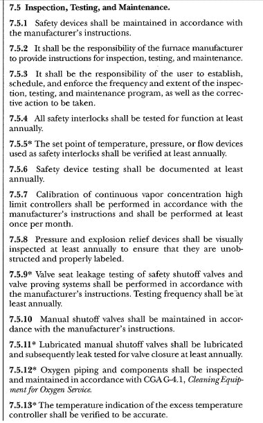

Natural gas fuel lines for boilers/furnaces/heaters use quick-close Safety Shut-off Valves (SSV) when tripped on loss of combustion flame detection.
In the USA, NFPA 85 is the standard for boilers, NFPA 86 for devices with burners over 400,000 BTU.
Here's a summary of NFPA 86 from the section on Inspection, Testing and Maintenance from a decade ago (NFPA updates on a 4 year interval).
Maxon manufacturers SSVs. Maxon's recommended functional test is described in this document:
Link
