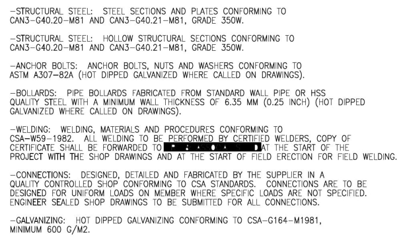

This was just from a recent project for me to review connectons... check the drawing notes... nearly half a century out of date. One of the worst I've encountered:
I must have my setup wrong - I don't see any file to review.
