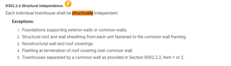

Our office doesn't do condos, but we do townnhomes with firewalls between to have independent LFRS like you say. The IRC provision is here:
My understanding of the intent is that if one unit burns down, the unit next door that was protected by the firewall still has to have a valid LFRS.

Daywalker - good call. The townhouses I've done have had the 2 hour party wall, so they're exempt from being 100% independent. Good reminder, though, so thanks.
