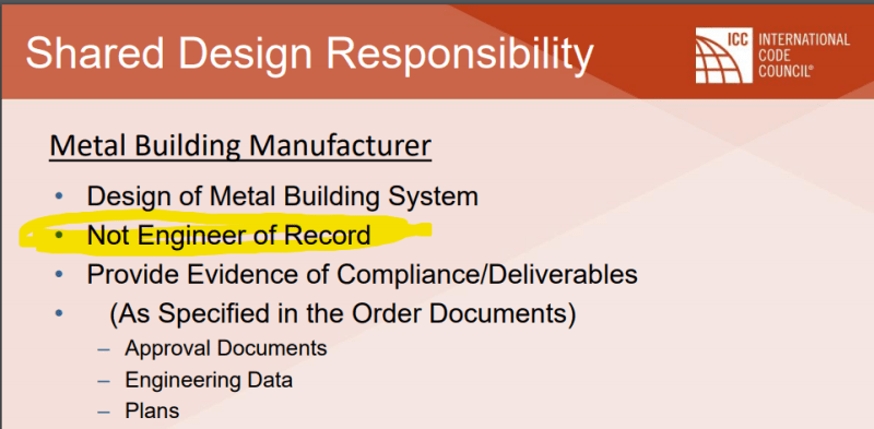

Part of the issue is prefab building supplier do not consider themselves the EOR and their contract is the building so they avoid the AHJ.
The owner could try re-entering negotiations with the PEMB to get the necessary information and documentation produced or hire an EOR. PEMBs generally consider their calculations propriety and do not share unless you can negotiate it in the contract/pay them for it.

Chapter 16 section 1603 of the IBC lists the minimum requirements for information to be placed on the plans. It seems to me that the PEMB engineer doesn't realize they are the EOR which is common as I have never seen the PEMB manufacturer/engineer act as such, typically the engineer doing the foundation design is the EOR and the PEMB is a deferred submittal. Is the PEMB engineer providing the foundation designs as well?
I would argue that if the PEMB engineer is providing above and beyond the PEMB design, then they are the EOR and are subject to the IBC, which lists the requirements on construction documents and gives the AHJ the ability to request more.

To some of the points about PEMBs - my SOP is this: if I'm brought in before the PEMB is designed, I'm the EOR and I write the spec for the PEMB. That way I can define the parameters (you know, the way the MBMA says it should be done) and not leave it up to chance. Then, when the design comes back below spec I send a copy to them and dip their design in red ink and I keep tightening the screws until they comply. If I'm brought in after the PEMB has been designed (or worse, after it's entered fabrication), I refuse to be the "EOR" and make the owner sign liability releases saying that I'll make sure the foundation is good, but I'm not responsible for the performance of the building. I don't like it, so I only do that when I'm hungry. If I don't need the work right now, I just turn those down.
