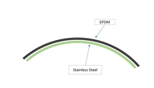

EPDM and Stainless steel bonding 1
Compositepro - the rubber compound needs cobalt naphthenate or similar mixed into it to help form the bond between the rubber and the brass plating.
forumtowers.com
Is it sheet? Cause your picture doesn't look like one.
I suggest if it was by compression molding process. Apply primer to the steel. Mold together with the rubber.
Interesting article Composite pro. It suggests that sulfur silanes may be a solution. As with all primers they must be applied while the surface is clean and chemically active. Solvent degrease, grit blast the metal, and bond.
Regards
Blakmax
@Ahmad Uzair
Yes , Both SS and EPDM are sheet . And also it is a mass production part. So looking for a cost effective solution too.
Both sheet need to bond by adhesive.
