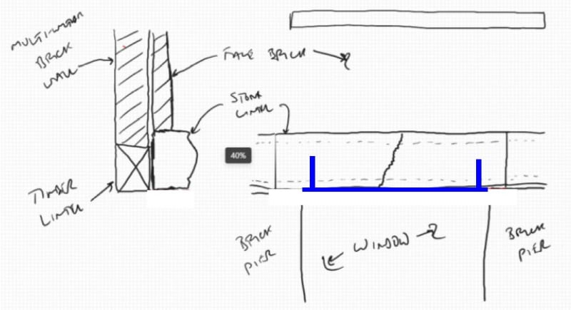

Anyone have any good recommendations for an epoxy that can bond steel to stone (assuming granite for now)? Existing lintel holding up face brick cracked during window install. Lead time for a replacement is prohibitive (original over 100 years old). I'm hoping to use the original stone and build a steel lintel to support it, but I need some nominal composite action. Sika says their anchor epoxy works with stone, but 1) they don't give values and 2) this is going to be more of a gluing a plate on shirt of thing. Anyone have a known product?

I don't understand the condition. Can you post a quick sketch, or photo?

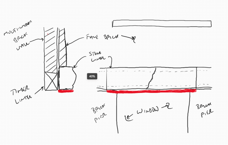

Sorry, dik - I was on my phone when I posted originally. Couldn't get a good photo, so I'll post a couple sketches:
So the ideal solution (minimal impact on schedule, doesn't require another trade - and a somewhat rare one at that) is what I have sketched in red. Strip the face brick from lintel to the sill above it and remove the lintel. I'm thinking some dowels and epoxy to mend the lintel itself and support it on a flat bar. Sadly a flat bar of appropriate thickness doesn't cut it - it wouldn't be stiff enough and the epoxy in the lintel would do all the work anyway. So I'm trying to come up with a product that I can use to feel good about composite action between the plate and the stone. Carbon fiber would probably be a better choice, but again that would require bringing in another trade. A steel angle would certainly work (these windows aren't large), but there's no room for upturned angle without modifying the stone, and that requires a stone mason if they don't want to risk damaging it even more.
This may be a terrible idea, so I figured I'd throw it at the wall here and see if it stuck - if anyone know of a good epoxy to make it stick. I'm not afraid to tell the contractor what needs to be done, but these guys go out of their way to try to make my job easier in most cases. So I'm trying to explore more...exotic options for their benefit.

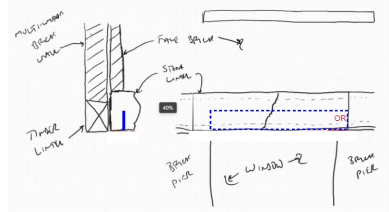

Can you sawcut it 1/4" or 3/8" and insert and 'glue' an HDG steel plate, on edge? Less visual... I've done that a few times. Is the sound part of the stone at the supports in good condition? How large is the span and is there adequate arching action over it. You have to be careful with epoxies and zinc. Your approach with the plate on the flat works, using the epoxy to secure the plate to the stone.

They don't want to cut the stone - it seems to be in fair condition, but without an experienced stone mason they're concerned that they could do more harm than good. Drywall is already staged, and windows arrive in 2 weeks, so ordering a replacement stone to be cut or to cast a replica would eviscerate their schedule. They're just "fortunate" that they picked this one to do the mock-up and we can solve it before it's a critical path delay.
Span is only about 38", and there's a good 40" of brick over it to the underside of the sill (that unmarked, long rectangle on my sketch), so it'll arch.

or (The things at the end are pins):

dik - I'll check them out as well. I thought about the pins, but I hadn't satisfied myself on how to go about it. If the bottom were hidden I'd just have them bolt it, but I'm not sure about welding pins to the plate, drilling holes in the stone, filling them with epoxy and spreading epoxy over the surface and then dropping the plate into place. Maybe it could work well enough...

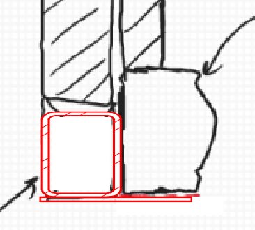

IRstuff - right, but cutting the stone would be required. My sloppy electronic penmanship did no favors - there's no gap between the stone and the brick behind. And if the angle were turned down it would be in the way of the window installation.

Could the stone not just be reinstalled the 1/4" or 5/16" of the angle vertical leg thickness? Or is all of the face lines that tight on the brick? It would look intentional almost and solve a whole bunch of issues.

The more I've thought about it the more I like just using an angle, so I've asked the contractor to do a little more exploratory demo once they have some shoring/sidewalk protection in place. The back is tight to the brick and the face is a continuous band around the building, so something has to give to get it in there, but I think that'll be preferable to epoxy.
