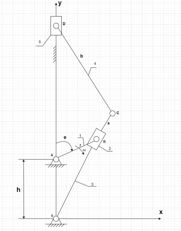

Hello everybody,
I need to write all the equations for each component for this kinematic system. Then, I will need to calculate velocity, acceleration and displacement.
Would you be able to help?
for a given omega, you can define the point (the center of the small block) in terms of r, phi, and omega and omega-dot.
vector "j" is a bit tricky, but you should be able to determine the mag and arg of the vector.
the orientation of the block is a little tricky.
i assume point "d" is limited to vertical motion.

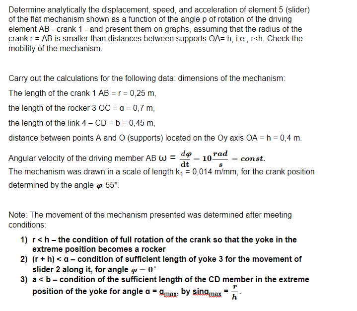

Hello rb1957, actually I realized I haven't even given the assumptions and parameters of the system. Let me share with you, in case it would help you and me so solve them:
equations of motion describe how the parts of the system move/change as some governing input changes, like y = f(x). here the governing input should be the angle "phi" and omega (omega can't be constant, unless the arm rotates 360 degrees. It can have a momentary value, but for me the position and motion of "B" should be determined by phi and omega. For example, the length of "3" is R+h when phi = 0 and something less as phi increases (when phi = 30deg, L3 = sqrt((R*cos 30)^3+(h +R*sin30)^2) ... yes ?
and D is at R+a+b when phi = 0

Sorry I'm a beginner in theory of machines. In this case omega w is given as constant which means the arm rotates 360 degrees (angular velocity is const.). In order to calculate position and motion of B, I though angular velocity as first would be calculated as w(omega) = r x phi ? I'm trying to solve easier ones now before I move to this one.
no ... omega is really phi_dot. phi and r give you the cartesian co-ords of the end of the radius, pt B ?
does B slide along 0-C ?
is "a" the length of the slider, or is "a" a fixed length between B and C ?

if omega is constant then the radius rotates about 0 and you can determine the co-ords of the end of the radius as a function of time. As you know, the end of the radius moves with a speed of omega*r. As the end of the radius moves, how does length 3 change ? look at some "obvious" positions, run excel with many values of phi. how long does it take for phi to change by 1 degree ? plot the results, some patterns may become visible. how does pt C and D move ?

Are you solving this graphically using velocity diagrams - in which case i can't remember anything, or by geometry?
If the latter
Get the position of B as a function of phi
get the position of C as a function of the position of B
get the position of D as a function of the position of C
None of that is anything more than basic trig.

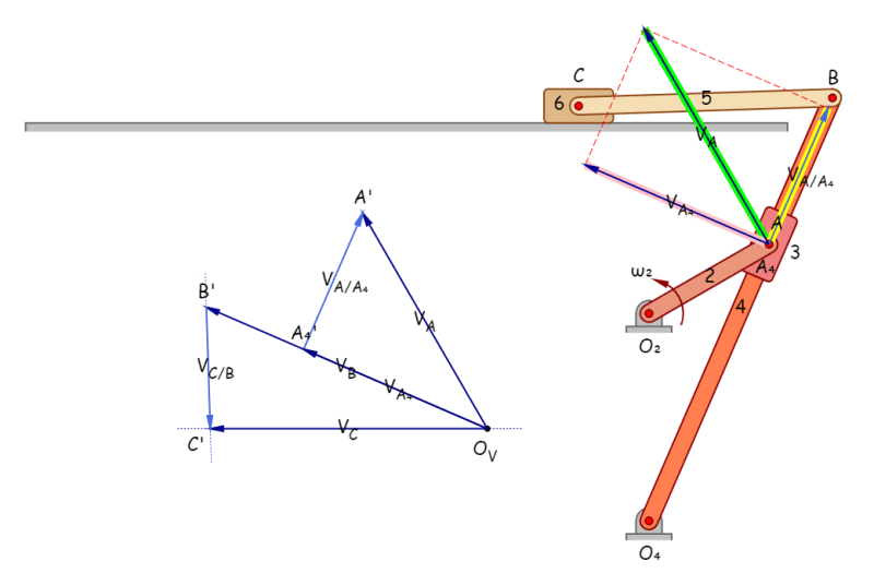

Hello Greg, I need to solve them graphically using the diagrams of velocity, displacement and acceleration in python. So, in reality I should write all the equations to solve the current state of the system and then make it possible for other values to work as well.
I hope you find success in solving your problem. I wanted to share a video that I believe will be extremely useful for you. The solution explained in the video addresses a problem very similar to yours, focusing specifically on velocity analysis.
