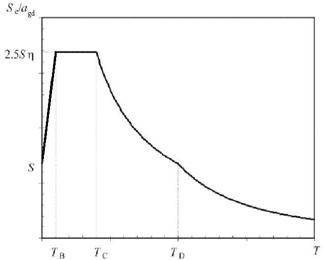

Regarding the Tb and Tc values, you may look to national annex applicable at your region. For example , for soil type A, spectrum type 1, Tc=0.4 sec.
For this case , the fundamental period T1 shall be less than 1.6 sec.
I have atteched the typical Shape of elastic response spectrum for explanation of Tb,Tc, Td…
