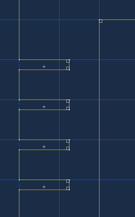

I am trying to make an array of narrow, straight cuts (as the two in the image below) in a rectangular 2d part made of shell elements.
However, I keep getting the error 'Cut extrude feature failed', or if I try using the Linear Pattern (see image below) or Translate features, I get 'Section must be closed for this type of feature'.
I don't understand what is going on. Can someone please help?

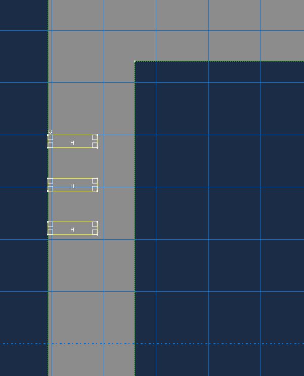

Extruded cut can't be used for 2D parts but you can sketch the part already with cutouts or use Partition Face: Sketch option and then delete the newly created face (Geometry Edit --> Face --> Remove).
I tried your partition: Sketch approach (with Linear Array), but I got the following error:
Could you tell me how to go about sketching the part directly with cutouts?
First approach (partition and removal):
Second approach (part drawn with cutouts already):
