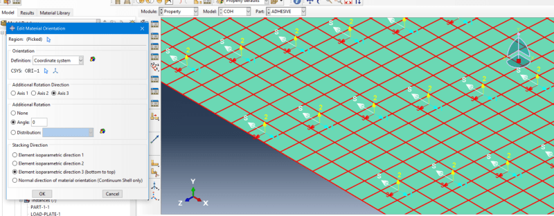

Hi ,
I am getting the following error in the .msg file. How to overcome this ?
***ERROR: The user defined normal of the material orientation of 46000
elements, as defined in *ORIENTATION, is orthogonal to the GASKET,
COHESIVE, SHELL or MEMBRANE normal direction. Check input data. The
elements have been identified in element set
ErrElemUserNormMatOrient.
ASYNCHRONOUS OUTPUT DATABASE FRAME FLUSH STARTED
Thanks,
Vaidehi
Check the documentation chapter "Orientations" (paragraph "Use with shell, membrane, or gasket elements or contact surfaces". It describes the projection algorithm used by Abaqus when user-defined orientation is applied to aforementioned elements.
