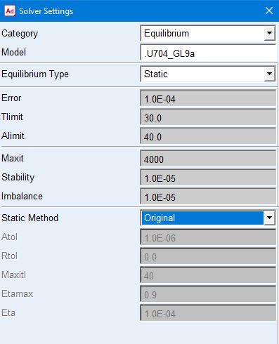

i have made a twist beam suspension model assembly on a testrig and when i get a test when performing it on the wheel centers instead of the contact patch, i get this error:
Static equilibrium analysis has not been successful.
The maximum number of iterations 25, has been reached.
For the last attempted iteration:
The equation with the largest error was model.rear.fbs_twist_beam Comp = 8 Error = 27297.105773
The variable receiving the largest increment was model.rear.ipl_fixed_5 Comp = 3 Delta = 77017.969068.
---- END: ERROR ----
Static Solution failed to converge
End Static Solution
Simulation failed

i have tried changing the joints but when i do that, i get an error about the jack testrig...
would anyone please help?
FYI the interface that i have created is placed on the twist beam and is the location of the bumpstop which is placed on the twist beam...
thanks as always... i will try that
how should i do that?
i know about the error in the solver setting but how about the iterations?
I haven't got ADAMS on this machine, it should be in the static tab of solver settings, called maxit probably.

Whenever you run into a static equilibrium problem check that these settings haven't changed, and if they haven't, change them. This rather infuriating advice is the best I can offer. There is an MSC course on how the Solver works, which does at least make sense of the individual parameters. the help file is a good place to start. The MSC recommended settings for even quite similar models do vary.
Error is the single most powerful parameter, some models solve better with a bit more error, some with less.
