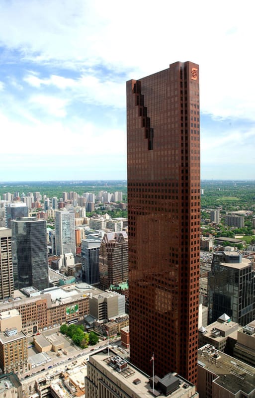

The building's stats alone are impressive: 1,496 corner offices, 44 elevator cars, 28,000 exterior tiles, 5,000 windows, and 18,500 lights, all subtly brightened and dimmed automatically by a light sensing computer. A giant 2.95 million litre water tank in the basement circulates water through each floor, cooling in summer and heating in winter much like the Toronto's Enwave system does today.
toronto scotia plaza
Suddenly, with the building approaching full height, a faulty driveshaft in a construction elevator failed. The knock-on effect sent a car carrying two workers racing at more than 100 km/h toward the top of the shaft. Both were killed on impact and another man caught in the wreck was seriously injured. All work was suspended pending an investigation.
