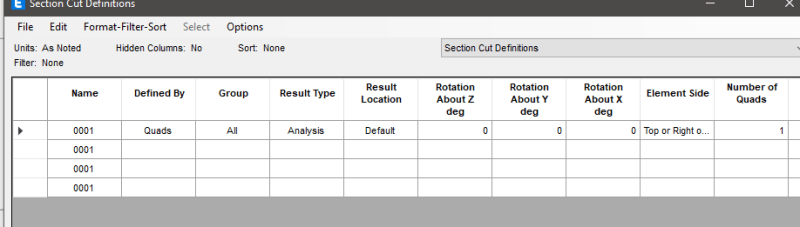

In the example above, I am trying make one section cut, based on the quadrilateral definition, with the four points being [0,10,0], [10,10,0], [10,10,1], [0,10,1].

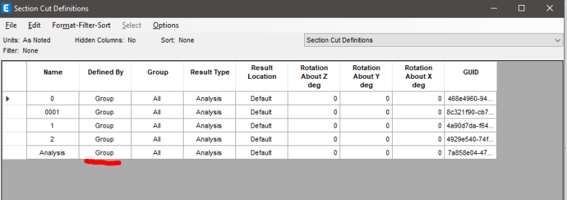

The result of running this code creates (6) section cuts, all being defined by group and not quadrilateral, weird behavior.
The result that I am looking for would look something like this:
The data I have prepared to be input in the database table mimics this appearance, save the GUID first row last column. When I made the python script in v19, I just set this to "1" and it worked.

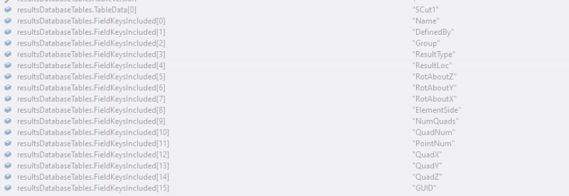

I also ran the GetTableForDisplayArray function to review the data output from ETABs and I cannot spot any difference in the data I am feeding the program verse what the program is returning.

I reviewed the import log warnings, you can see the program throws an error on import:
Code:
"********** DATABASE IMPORT DEFINITION DATA **********\r\n\r\nETABS Version 20.3.0 Interactive Database Import
\r\nImport Type and Options:  Interactive Database Editing\r\n     Elements Deleted from DB:  Delete object from model\r\n
Other Items Deleted from DB:  Delete item from model\r\n
Elements with Same Name in Model and DB:  Replace object in model\r\n     Other Items with Same Name in Model and DB:  Replace item in model\r\n
Elements (Except Links) in the Same Location:  Allow duplicates in the same location\r\n     Link Elements in the Same Location:  Allow duplicates in the same location\r\n
Items With Same Name in a DB Table:  Overwrite previous item\r\n
Import Control for Errors:  Abort import after 20 errors\r\n
Import Control for Warnings:  Abort import after 200 warnings\r\n\r\nImport started at \r\n\r\nImport completed at 8:55:04 AM\r\nNumber of errors:  10\r\nNumber of warnings:  0\r\nNumber of informational messages:
0\r\n\r\n\r\n********** DATABASE IMPORT SUMMARY LOG **********\r\n\r\nSection Cut Definitions Table:  12 of 22 records successfully read\r\n\r\n\r\n\r\n\r\n********** DATABASE IMPORT DETAILED LOG
**********\r\n\r\n*** Error Message 1 ***\r\nTable name:  SECTION CUT DEFINITIONS\r\nField name:  GROUP\r\nRecord:  2\r\nItem 0 not recognized; default value assumed
\r\n\r\n*** Error Message 2 ***\r\nTable name:  SECTION CUT DEFINITIONS\r\nField name:  GROUP\r\nRecord:  3\r\nItem Top or Right or Positive3 not recognized; default value assumed
\r\n\r\n*** Error Message 3 ***\r\nTable name:  SECTION CUT DEFINITIONS\r\nField name:  GROUP\r\nRecord:  4\r\nItem 1 not recognized; default value assumed
\r\n\r\n*** Error Message 4 ***\r\nTable name:  SECTION CUT DEFINITIONS\r\nField name:  GROUP\r\nRecord:  5\r\nItem 0 not recognized; default value assumed
\r\n\r\n*** Error Message 5 ***\r\nTable name:  SECTION CUT DEFINITIONS\r\nField name:  NAME\r\nRecord:  9\r\nName field is blank; record skipped
\r\n\r\n*** Error Message 6 ***\r\nTable name:  SECTION CUT DEFINITIONS\r\nField name:  GROUP\r\nRecord:  10\r\nItem 10 not recognized; default value assumed
\r\n\r\n*** Error Message 7 ***\r\nTable name:  SECTION CUT DEFINITIONS\r\nField name:  GROUP\r\nRecord:  11\r\nItem 0001 not recognized; default value assumed
\r\n\r\n*** Error Message 8 ***\r\nTable name:  SECTION CUT DEFINITIONS\r\nField name:  GROUP\r\nRecord:  15\r\nItem 10 not recognized; default value assumed
\r\n\r\n*** Error Message 9 ***\r\nTable name:  SECTION CUT DEFINITIONS\r\nField name:  NAME\r\nRecord:  20\r\nName field is blank; record skipped
\r\n\r\n*** Error Message 10 ***\r\nTable name:  SECTION CUT DEFINITIONS\r\nField name:  GROUP\r\nRecord:  21\r\nItem 1 not recognized; default value assumed\r\n\r\nSection Cut Definitions Table:  12 of 22 records successfully read\r\n"

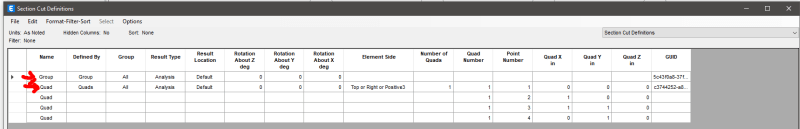

I am not quite sure how to resolve this, one of the odds things I noticed when reviewing the database table was that the size of the table changes depending on how you define the section cut. If the section cut is defined by groups, the tables has 9 columns. If the table consists of either both groups and quadrilaterals or just quadrilaterals, there are 16 columns in the table.
Groups, 9 columns:
Quads or Groups and Quads, 16 columns:
I wish I still had access to ETABs v19 to see if this behavior was the same back in the day. It looks like our license no longer works for v19.

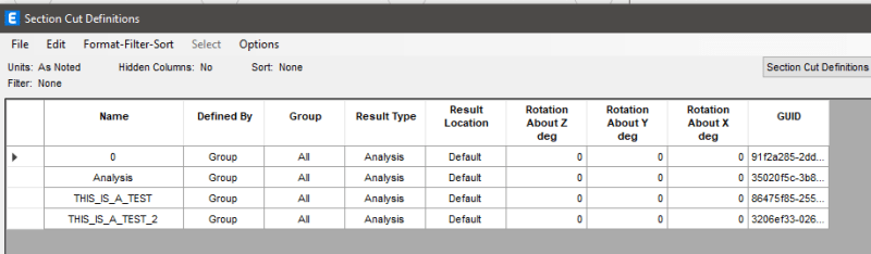

Playing a bit more, I was able to make section cut definitions based on groups, but still with some odd extra results.
Code:
string[] testETABs_Section_Cut_Data = new string[] { };
            string[] teststring1 = new string[]
                { "THIS_IS_A_TEST", "Group", "All", "Analysis", "Default", "0","0","0","1"};
            string[] teststring2 = new string[]
                { "THIS_IS_A_TEST_2", "Group", "All", "Analysis", "Default", "0","0","0","1"};
            testETABs_Section_Cut_Data = teststring1.Concat(teststring2).ToArray();
            int TableVersiontest = 1;
            string[] FieldKeysIncludedtest = new string[] {"Name", "Defined By", "Group", "Result Type", "Rotation About Z", "Rotation About Y", "Rotation About X", "GUID"};
            int NumberRecordstest = 2;
            _SapModel.DatabaseTables.SetTableForEditingArray(TableKey, ref TableVersiontest, ref FieldKeysIncludedtest, NumberRecordstest, ref testETABs_Section_Cut_Data);
            bool FillImportLog = true;
            int NumFatalErrors = 0;
            int NumErrorMsgs = 0;
            int NumWarnMsgs = 0;
            int NumInfoMsgs = 0;
            string ImportLog = "";
            _SapModel.DatabaseTables.ApplyEditedTables(FillImportLog,ref NumFatalErrors, ref NumErrorMsgs, ref NumWarnMsgs, ref NumInfoMsgs, ref ImportLog);

I was able to figure this out finally, turns out the headers of the tables do not always match the "coded" headers.
An example, you can see "Rotation About Z" in the visible column header has become "RotAboutZ" in the coded output.
